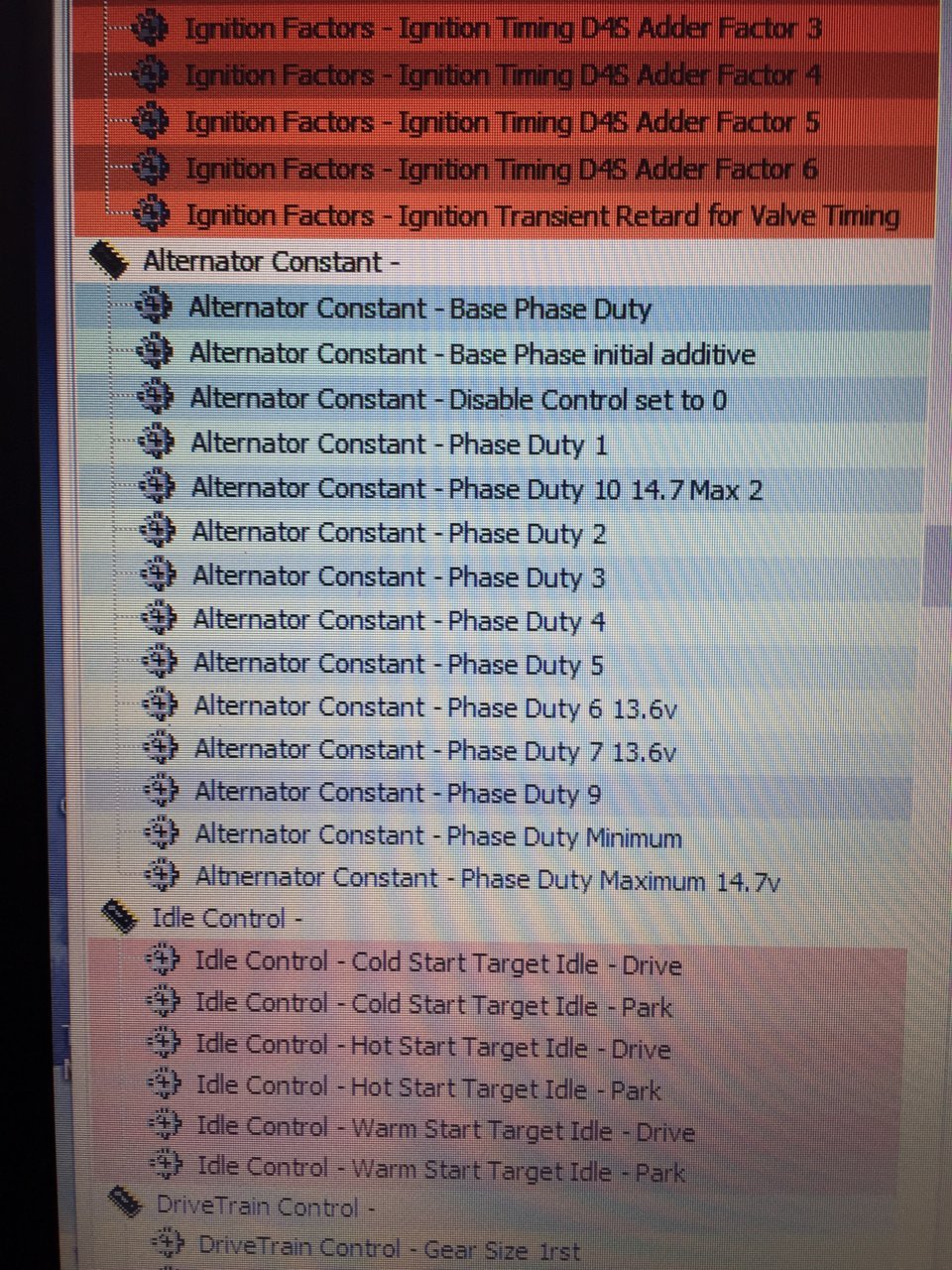

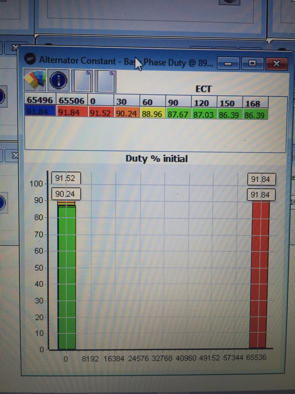

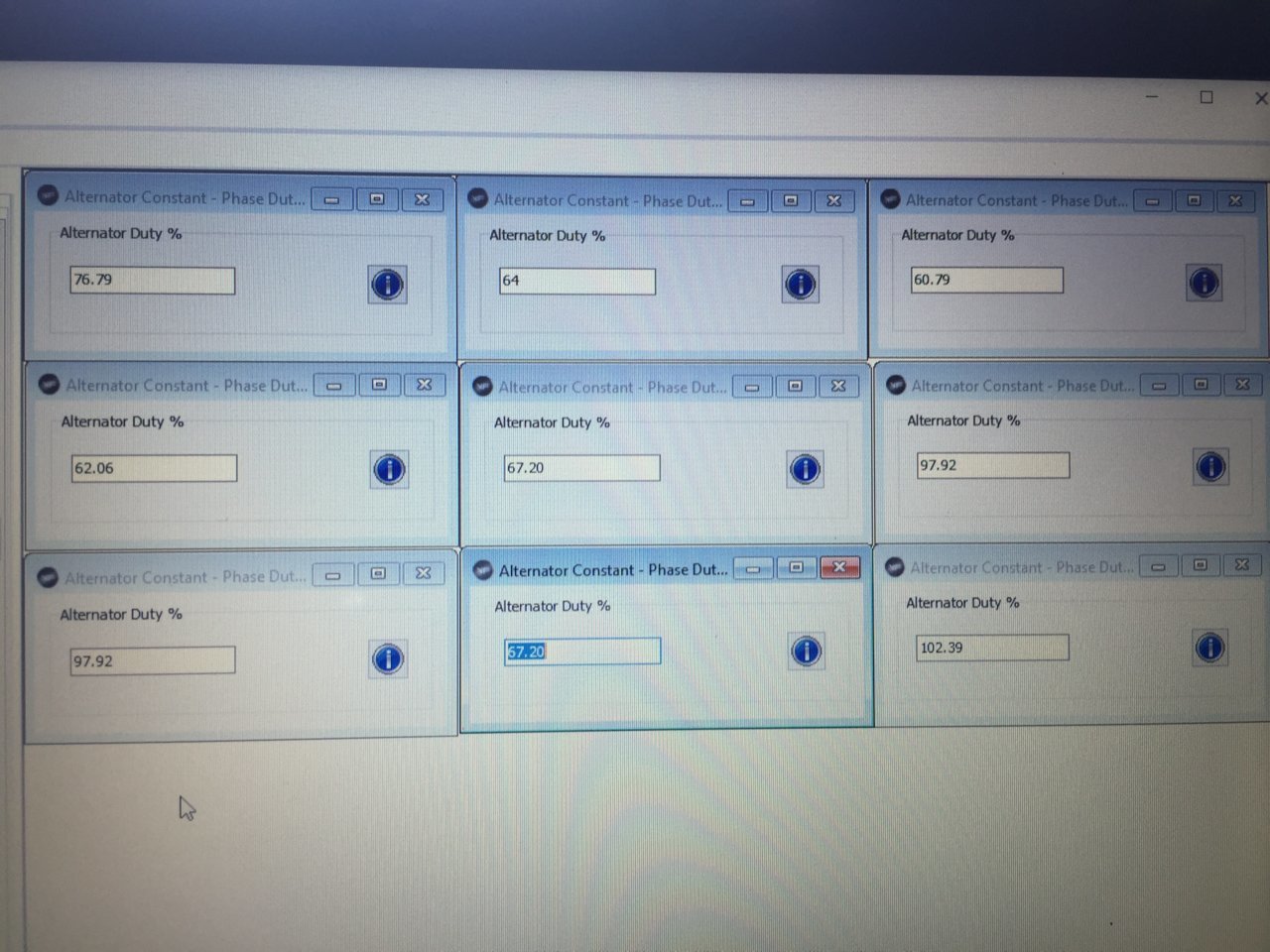

    So for AGM,
    Change these individual views to “94”?
    These are Alt constant- phase duty 1-10 (there is no 8)
    Or do I just adjust the “Base Phase Duty” to 94 on the "30-168" columns?

    Here are the settings I used:
    ECT set to 95 30 and up only.
    Phase duty 1 14.7
    Phase duty 2 90
    Phase duty 3 95
    Phase duty 4 90
    Phase duty 5 95
    Phase duty 6 13.6 - 102.39
    Phase duty 7 13.6 - 102.39
    Phase duty 9 - 90
    Phase duty 10 14.7 max 2 - 102.39
    Disable control set to 0 - 3.57
    Base phase additional additive - 0
    Phase duty minimum - 67.84
    Phase duty maximum 14.7 - 102.39
    That got me to 14.6-14.7
  13. Sep 4, 2020 at 12:21 PM

    Phase 1 duty is a percentage, not a whole number. Why 14.7?
  14. Sep 4, 2020 at 12:22 PM
    #3794
    ihatemytruck
    ihatemytruck Smartass
    Jul 26, 2013
    #109078
    1,636
    Dave
    Southern California
    '17 Tacoma 4x4 off road DCLB
    No idea.....just went off another users post, but it works
