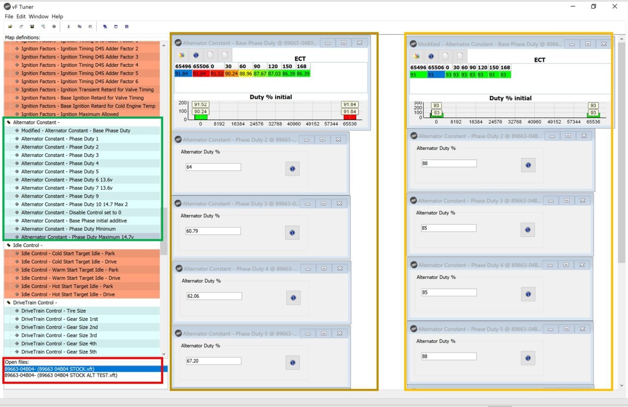

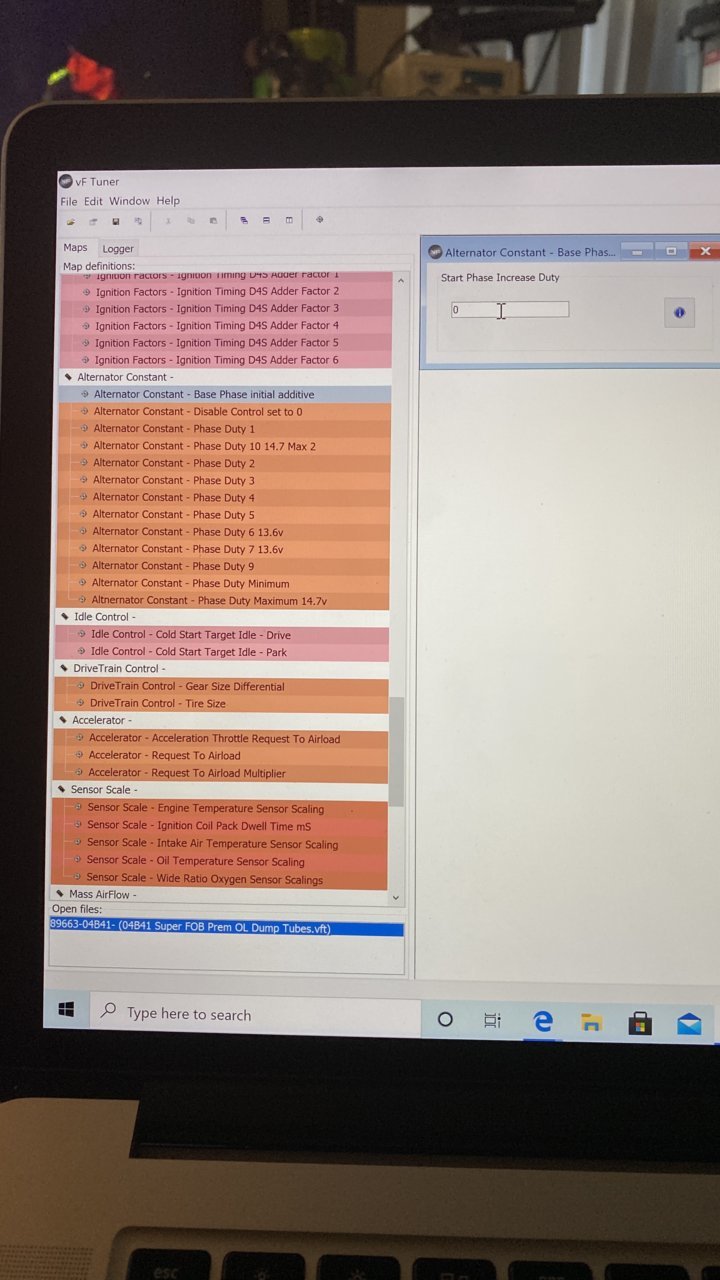

    Double click base phase initial additive. A window should pop up and it will have a 2d table with numbers on top

    Double clicked no 2d table
