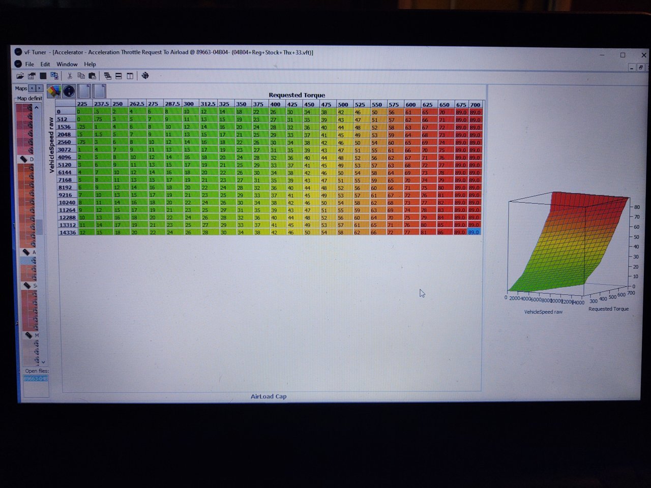

    Just finished dinner. Going to flash now... It makes sense in my head...

    I've tried to figure this out, I'm pretty good at figuring things out. But what the hell do all the numbers mean
    Speed, torque etc, they aren't in mph, rpm, or lbft from what i can tell.
    Can someone explain this madness.

    They are Maximum Throttle angle allowed based on calculated torque split vs vehicle speed.
    Calculated torque split is Optimal torque + WOP Torque / Calc Torque
    FYI..........
    We found throttle limiters for:
    1rst gear 4Low
    1rst gear 4High?
    1rst GEAR!!!!!!!
    R gear? < needs test

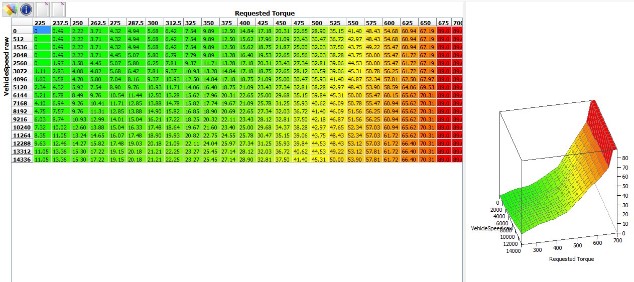

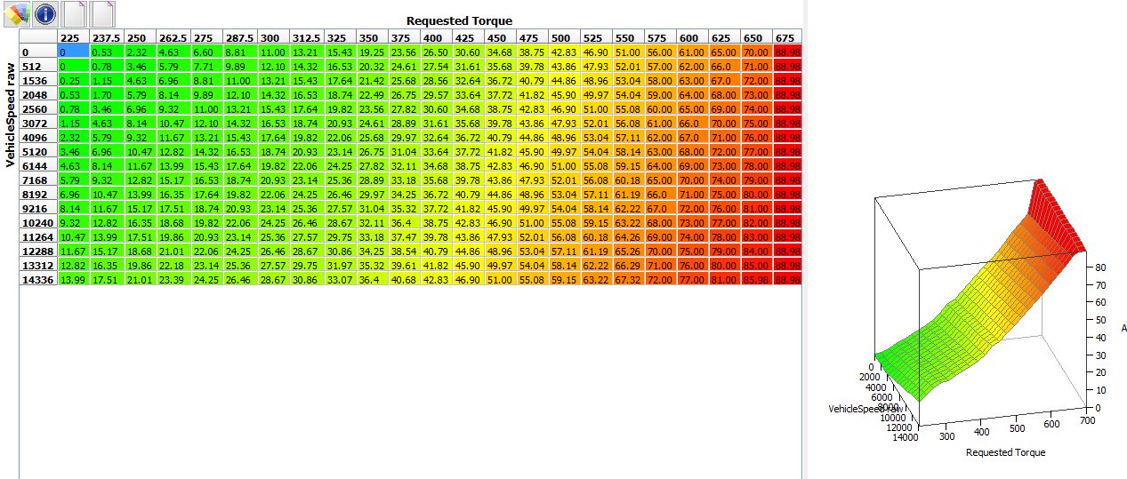

    Well I ended up tweaking my original throttle tune. Here is a stock THX vs my THX tweaked. I'm rather happy with the results. Not ridiculous, but ALIVE :burnrubber:
