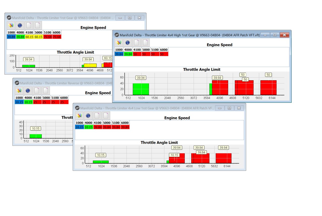

    That would be great for decreasing throttle sensitivity for off road stuff...... thanks!

    That's gonna be a nice touch. Tweaky in the high gears, and able to be modulated in the low gears. I like it...
    Any approximate dates when you'll have the Tow Tune available? If there's one thing I would do to this truck, it would be eliminate that damn Atkinson's cycle. I want all available power all the time, not when it feels like I need it. Keep up the good work @OVTune

    This isn't to limit sensitivity, these tables limit how far the throttle can open.
    So for example you floor it in 4low.
    The max throttle the ECU will let you have is 40*.

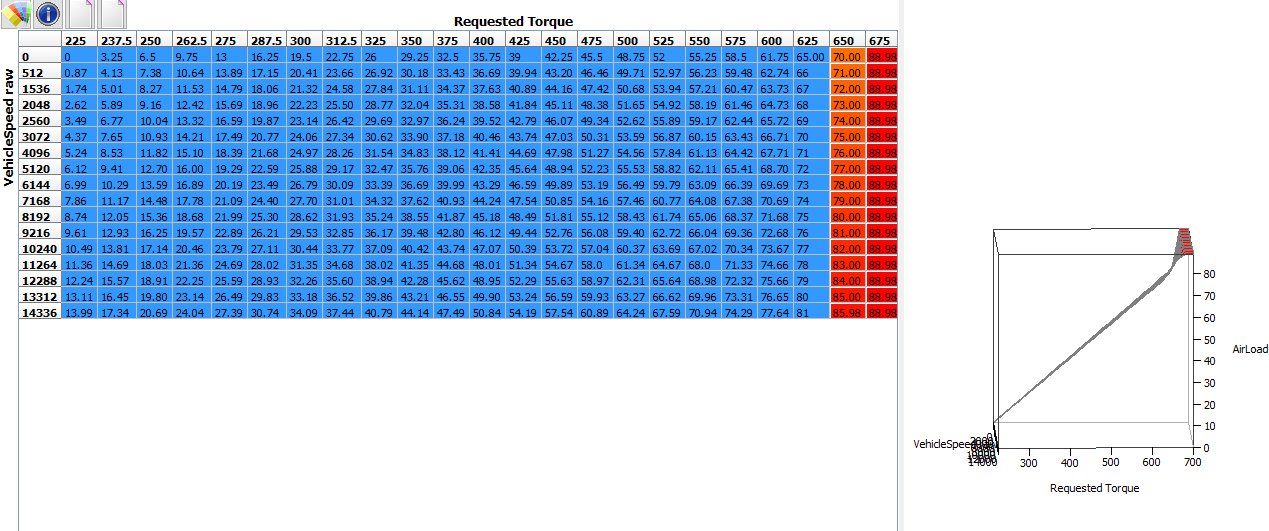

    I did the whole thing individually except the last two 89.9 sections i left alone as per @OVTune
    I basically went across the field trying to increase top to bottom and left to right in smooth transition that had a bit of a uphill climb to it.
    I tried running that and I wasn't quite satisfied with the very beginning of the pedal. So I started using the multiplier until it looked better. Saved, flashed, LOVED! Granted it needs to be ran for a bit to be 100% sure, but thus far I like what I've done. Spent hours doing it. Not gonna lie :D

    Why would you want to limit the maximum amount of throttle? Essentially putting a block under the gas pedal right?

    Gotcha. Is there somewhere we could make the sensitivity in 4lo different than in drive?

    Highlight area, CTRL +F to set value in highlighted area
    Then, highlight an area, CTRL+ i to interpolate and smooth.
    Will be much easier than setting individual values

    @OVTune
    If I want to take my tweaked tune, and then try the CTRL + I version of that tune, what is the best way to ensure I save two separately saved tunes so I can go back without saving over my other stuff. I'm used to a "save as" option and I can't wrap my head around this. :O
  14. Sep 5, 2020 at 6:48 PM
    #3874
    Mooseditty17
    Mooseditty17 Seasoned Rookie
    Apr 7, 2019
    #289395
    1,681
    AJ
    WI
    2017 TRD OR : M+W Nexus Tuned
    Tune: Nexus +P Add ons: +3" custom suspension 295/70/18 Yokohama M/T Tires KMC XD Grenade OR wheels KN intake Blackhawk MBRP Exhaust TJM Rock Crawler Bumper Lighting (+10 H.P.)
    CTRL + I.jpg OMG... I just did what took me hours on my "tweaked tune" in .012583597 seconds with this little tid bit of information. And it' turned our WAY smoother. Now what's the best way to save this version of my "tweaked tune" so I have my original tweaked and a "Tweaked CTRL+I tune".

    What's the downside of a higher limit? I guess I should ask, why did Toyota set it where they did? More nanny control?
