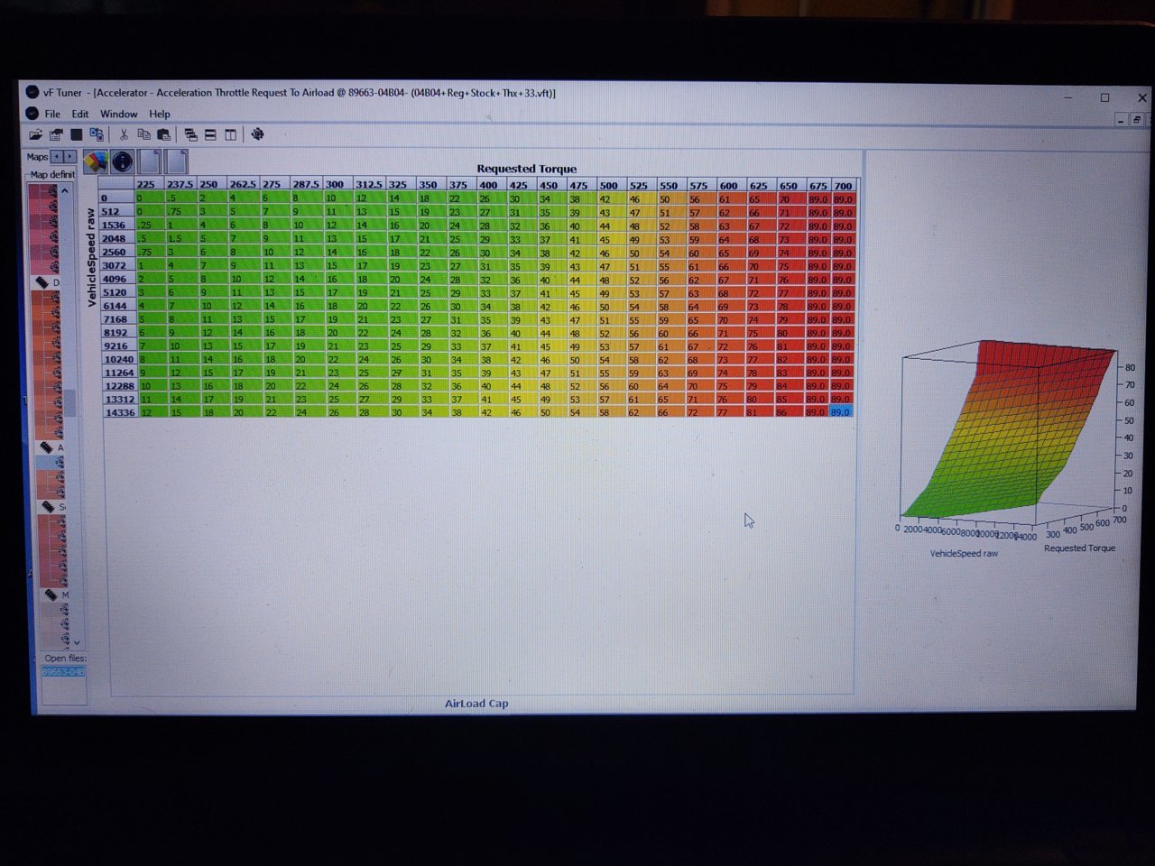

    I've been trying this multiply thing with CTRL F then where it says set values I enter (* 125) and it always tells me that the value must be between 0 and 1066.65

    I'm thinking it's cause * isn't a numerical value. I tried it as * 1.25 also and get the same message.
    I can't seem to do it any way I try it actually. If i highlight a single value and hit* nothing happens then when I type 125 it puts 125 as the new value. If I type*125 together it just enters 125 as the value. Same thing happens if i CTRL F a single value and type and when i highlight a complete section then CTRL F it gives me the message I need to set a value between 0 and whatever.
    Right now it looks like the only way I can change values of a whole map is to individually change each individual number so I pretty sure i'm missing something
    Maybe @OVTune can give a listing of all the commands to us like CTRL F and CTRL I and how to use the commands properly
  10. Sep 6, 2020 at 12:57 PM
    #3890
    OVTune
    OVTune Well-Known Member
    Mar 27, 2017
    #214557
    8,112
    OVTune
    just press the * button, no CTRL F, etc
    a window will pop up asking how much to multiply the area by

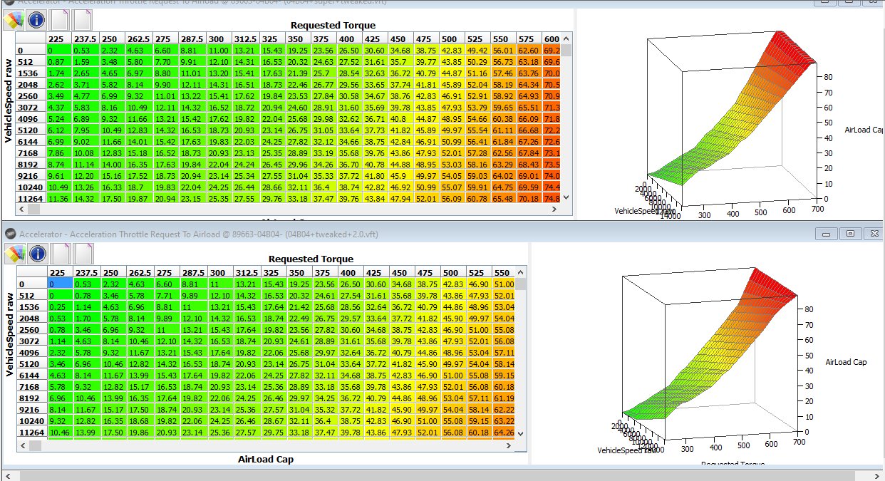

  13. Sep 6, 2020 at 2:14 PM
    #3893
    Mooseditty17
    Mooseditty17 Seasoned Rookie
    Apr 7, 2019
    #289395
    1,681
    AJ
    WI
    2017 TRD OR : M+W Nexus Tuned
    Tune: Nexus +P Add ons: +3" custom suspension 295/70/18 Yokohama M/T Tires KMC XD Grenade OR wheels KN intake Blackhawk MBRP Exhaust TJM Rock Crawler Bumper Lighting (+10 H.P.)
    Going to try the top one tomorrow. So far I'm very happy with the boosted throttle response. I'm not sure what to do next... anybody done any shift points?
    wahoobie and ihatemytruck like this.
