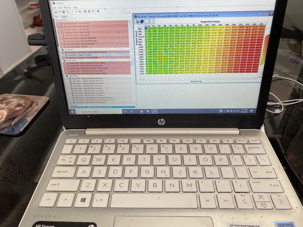

    I think that’s what @inksin was trying but unsuccessfully.

    It would work, you just need to make sure the Fn keys are disabled. There should be a way to do it, or use Fn+Shift+8.

    I tried shift +8, and didn't work, then tried with the number pad and it worked. Not sure about the Fn stuff though.

    Pillaging the closet of “that might be useful one day” crap gave me a free solution. A can multiply like a 3rd grade boss now.

    I can't see the image, it's not attached properly, but if you go into Flash Manager, you download the tune you wish to run, then go to the row of drop downs at the top and I can't remember what they say, but there will be one that gives you the option to open p5f utility. Open that up and then flash the tune
