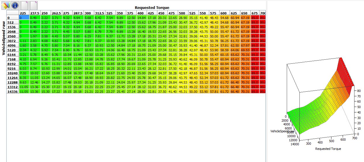

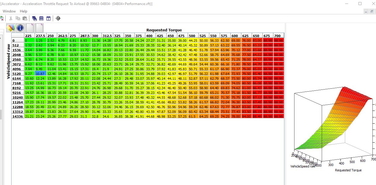

    Would you estimate that if we could look at the 1.05 performance tune throttle request in VFT format, it would look something like this?
    I'm obviously just going to try it anyways, but wondering what your thoughts are. Wondering if I'm headed in the right direction. Is it be more important that the numbers going left to right climb at a quicker rate or the numbers going top to bottom. I have no clue what they mean, even after your brief explanation... but it seems the graph on the right looks good :D

    Here's the unchanged file that I originally downloaded for comparison:
