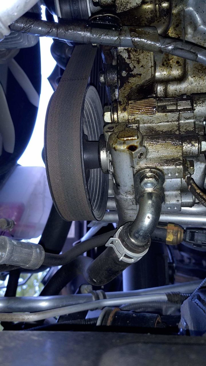

    Tomorrow I'm bringing the Taco in for a possible timing chain gasket leak... Not impressed. How many of you would feel the need to flash back to stock because of going to a dealer? Will they notice a difference, yes. But will they really give a shit???? Magnusson Ferguson act protects us from warranty being voided as long as it's not proven to be the reason for claim. Better shifting and a touchy throttle can't be to blame for a gasket leak. Especially since it started before I flashed!
    Thoughts??

    That gasket leak fix is a pretty big job. Either pulling the motor or a complete front end tear down. For something that massive (not an oil change or diff howl), I might think about flashing to Stock. The leak is totally unrelated, but unless you have a really good feel for your dealer, I would probably play it safe.
    Your Miles and Time from a DTC reset will be short. If they ask, just tell them that you pulled the battery cable while swapping a bulb somewhere. Any OBD app can reset the DTC counts.

    Appreciate the input. Not looking forward to this visit...
    No puddles, but a 3 year old truck shouldn't leak!!

    That's not good.
    As I have said, they really ought to come up with an external fix for this. Goop on JB Weld for all that I would care. :D

    Unpopular opinion- Id rather a small oil leak than my whole engine being fucked with. Unless this timing cover leak gets really bad over time. Haven’t followed the issue enough to know how bad it gets...
