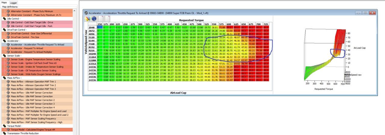

    What a strange place for an airflow dip, at high load conditions. What could possibly have been toyota’s rationale?

    I'm going to admit this stuff is a little over my pay grade but I'm wondering why there is such a dip in this table? I would think it would be more of a gradual ramp. Would there be any benefit to smoothing it out? Also what does the raw vehical speed equate to in MPH?@OVTune?

    If I make a change on the 2D table will that show up on the 3D table if I open it afterwards?

    On this example:
    @ 2.79% throttle it's allowing the throttle to open 1%?
    @ 5.5% throttle it's allowing the throttle to open 1.19%
    @8.29 - 1.79 % and so on?
    What kind of craziness would a guy get if he matched the numbers entered to the values at the top?
    Should each gear map go up equally as the one prior? If I increase the values on 1st gear by 10% across the board, should the same be done for 2nd through 6th to maintain a smooth transition through the gears?

    @OVTune Would there be any pros/cons to eliminating all the dips/humps and not just the ones in the 800-2000 range?
