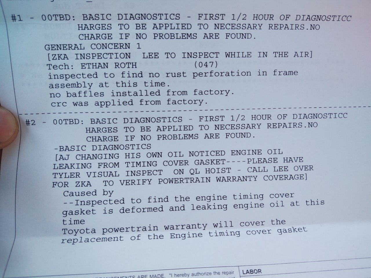

  11. Sep 10, 2020 at 3:23 PM
    #4131
    TWTaco
    TWTaco Well-Known Member
    Dec 19, 2015
    #172601
    5,967
    Dave
    You get your truck in to the dealer for that oil leak?

    Tune: Nexus +P Add ons: +3" custom suspension 295/70/18 Yokohama M/T Tires KMC XD Grenade OR wheels KN intake Blackhawk MBRP Exhaust TJM Rock Crawler Bumper Lighting (+10 H.P.)
