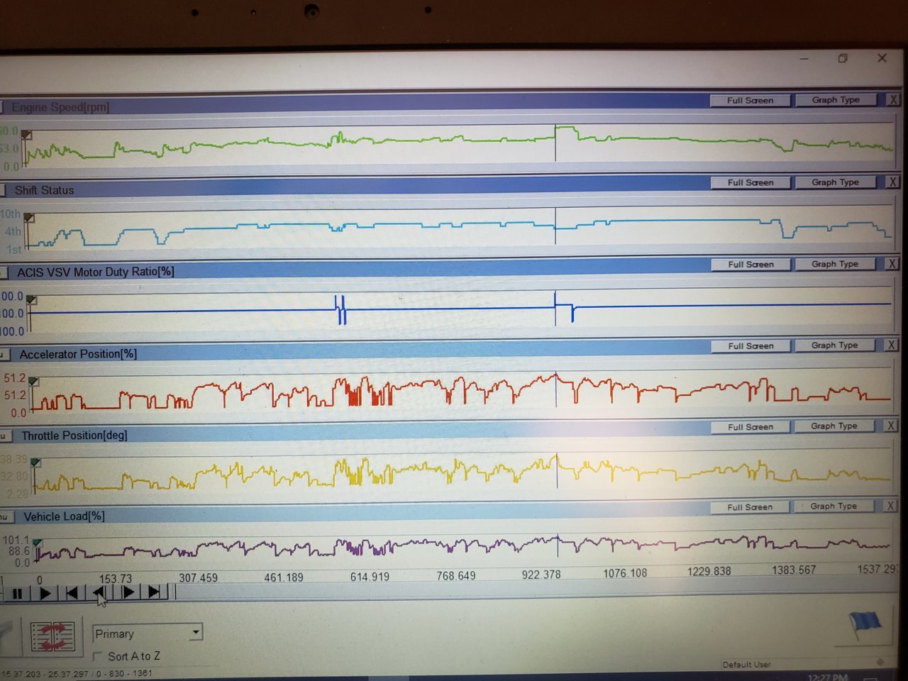

    I'm tring to understand this. Looking at 04B90 Super FOB Prem the ACIS Activation RPM High is set at 7250 and the RPM Low is set at 2700. So is the ACIS not set for optimum operation? I assume the ACIS opens linearly from 2700 RPM (starts to Open) to 7250RPM (Fully Open) in this file. Stock was Rpm High 3650 and RPM Low 2700. Was it changed just to get rid of the power surge that was talked about often?
    Anyone have any insight on this?

    I tried changing to 1 and saving but when I reopened the table it was back to a weird number. I think it's an issue with the current version of VF Tuner software

    I believe it flicks open quickly at that 2,700rpm setting. 7,250 is probably there to match the current rev limiter setting so it doesn't close.

    Hmmmm, maybe I'll try changing the rpm low to 3400 rpm like @OVTune mentioned. I'll try and data log the ACIS to see how it opens.

    Unless I'm not seeing something it doesn't seem that ACIS is available in the PID list to data log.

    You can see/log it with techstream I think.. ACIS duty or something like that.

    Yes, I found it in Techstream. The range is +/- 100% duty cycle. I havent had a chance to go log, but will post results when I do.

    When using stock calibration you can feel the surge around 3700 rpm, and that would make scene since the RPM high activation stock was 3650 RPM.

    It goes +100% on activation. Then settles between 16.9-17.2% up to 20+sec, in some cases only for a second or two.
    Then goes -100%
