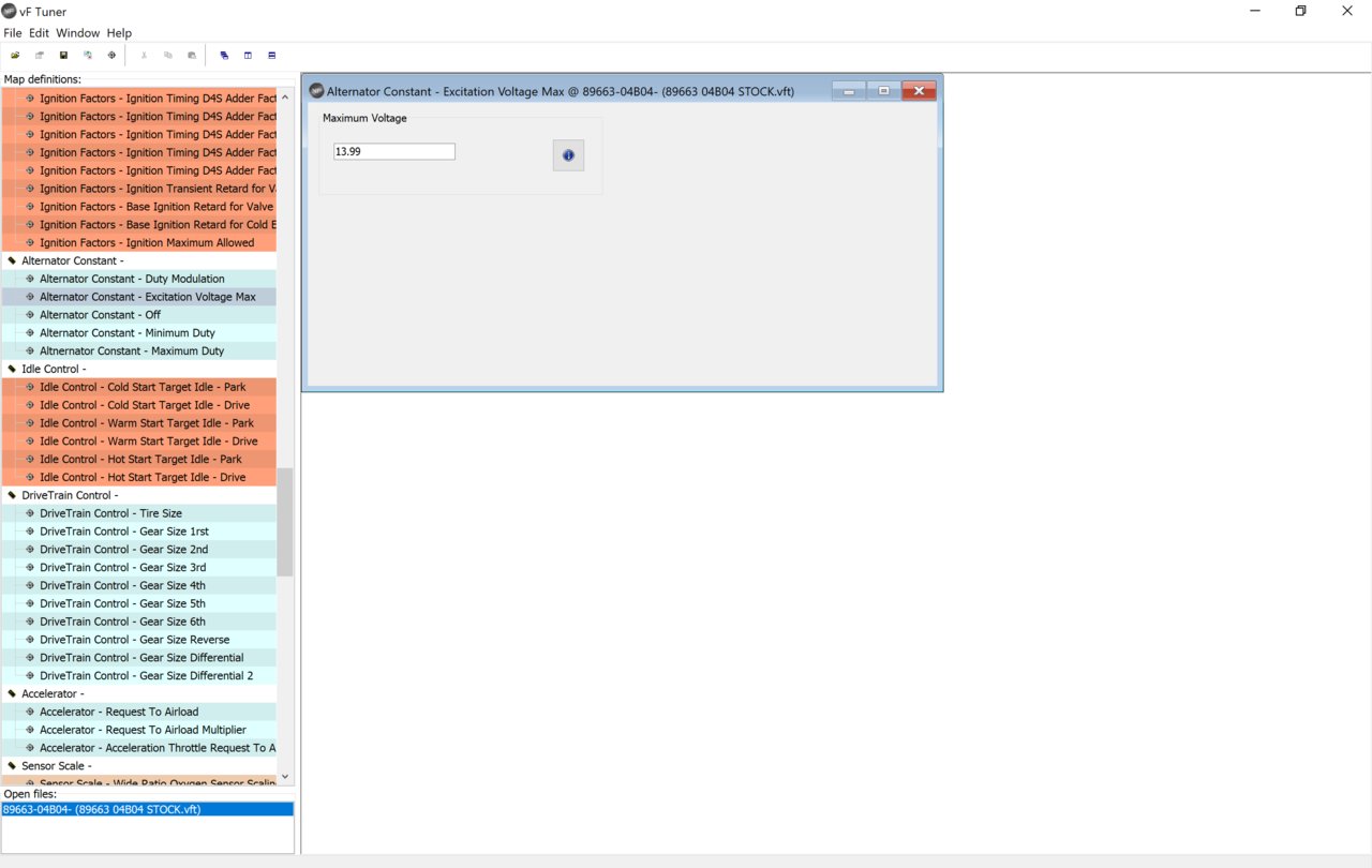

    Welp, I've got the software installed, unlocked the stock 04B04 ECU and have managed to find where I can change my alternator voltage. I have no idea what I'm doing, this seems dangerous, but I can't stop now...
    @OVTune, when do we get the 2.0 Final version to build from? My understanding is what I have access to here is the stock ECU and configuration. From here I can start over, but what I'd like and I'm guessing many other users, is the ability to start with 2.0F and change my alternator voltage, etc...
    So far, I am super impressed, but I'm also a complete noob just mashing on the keyboard. I save nothing at this point...

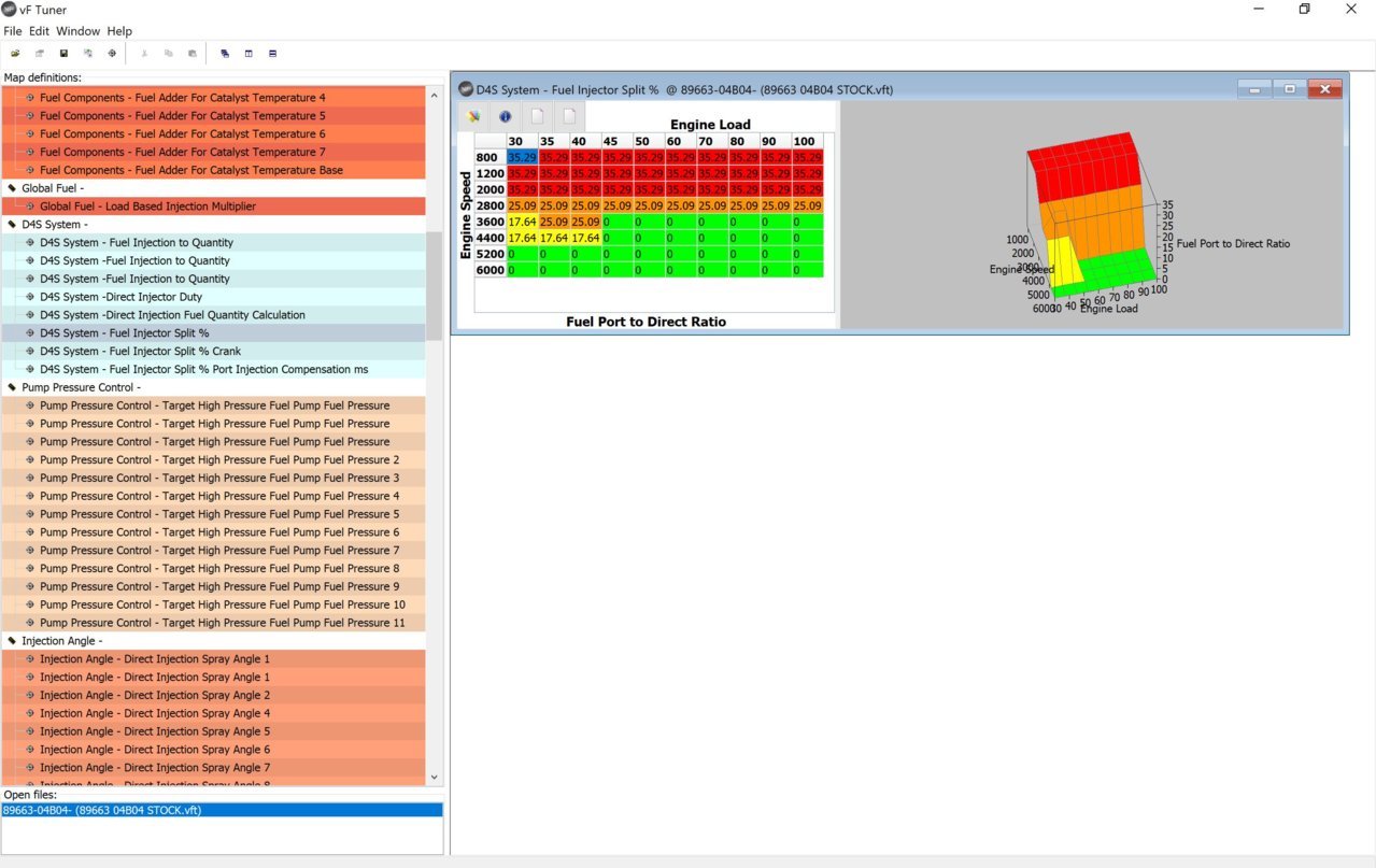

    I'm not putting my Tactrix cable or this laptop or this software anywhere near my truck until I can differentiate my asshole from my armpit in this thing (which I am no where near right now, it's all assholes, or armpits, or sweaty folds, I can’t tell, and I'm terrified but just keep poking like a confused teenager). Again, being a complete noob it's pretty sweet. I think I found an area that relates to some spirited discussions on the 1.05 thread...
    Also, to those having issues, just read the instructions linked in the email with your key. I’m a dumbass by many standards and managed to get it working following the directions.

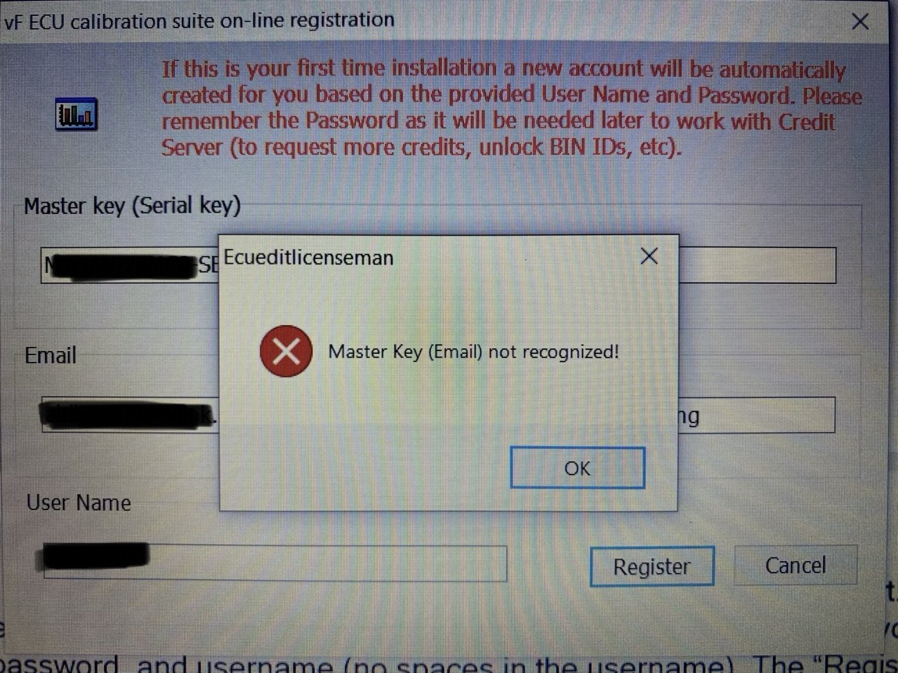

    @OVTune I also got the "Master Key(Email)not recognized". Followed directions that was sent in email link. Copied and pasted master key and email.
  6. May 1, 2020 at 11:56 PM
    #406
    LDS 77
    LDS 77 Well-Known Member
    Feb 19, 2017
    #211025
    168
    2016 OR
    Same here.

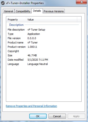

    Tried again this morning. still on 9. I give up. I have tried EVERYTHING. WTF

    deleted download , deleted shortcut,turned laptop off,cleared cache, disconnected from wifi,added firefox,added chrome, tried matts links. still at 9. computers are great when they work.
    SpeySquatch likes this.
  18. May 2, 2020 at 7:51 AM
    #418
    Buckfat
    Buckfat Well-Known Member
    Oct 27, 2019
    #309121
    159
    N GA
    2019 DCSB OR

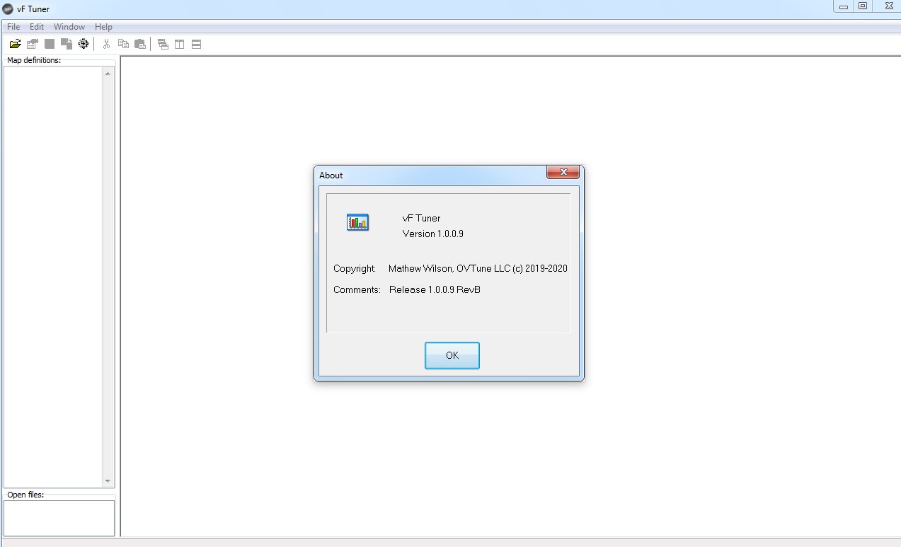

    Only thing i can think of is my downloads it says 11 but when i click on (about) when the tuner page is open it still says 9. I think thats what matt is referring to so i have been chasing my tail this whole time? That i do have 11 installed?:annoyed::typing::ohsnap:
    pinochle likes this.
  19. May 2, 2020 at 7:56 AM
    #419
    ben dover
    ben dover Well-Known Member
    Aug 3, 2017
    #225806
    104
    San Francisco Bay Area
    2017 TRD Pro
    Yeah, my exe file was 11 but the software says 9. I think you’re good to go!
  20. May 2, 2020 at 7:57 AM
    #420
    JaTe
    JaTe Well-Known Member
    Mar 1, 2015
    #149874
    514
    Maryland
    2017 Tacoma TRD OR DCSB
    If yours is like above pics, then yes it's correct.
