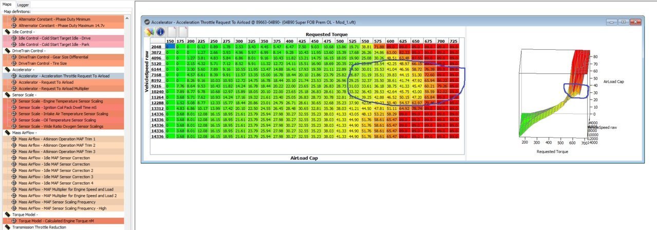

    @OVTune ,
    I've applied these changes to 04B41 Premium SFOB and am liking the results down low.
    I'd like to extend the highlighted area to include lower values in both the RPM and engine load axis, so that the smoothing effect comes on earlier.
    Thoughts? Words of caution lol?
    TBH, I had the tables looking like flat diagonal ramps at one point but was too chicken to flash it.

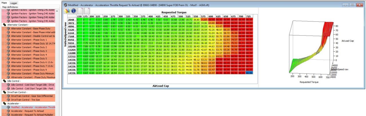

    I did this also with 04B90 SFOB premium and noticed a big improvement down low. Could take off from almost a dead stop in 2nd gear without lugging too bad. I was also wondering about smoothing out more of the table as well

    Forgot to mention I also ended up smoothing out a dip in this table.
    to

    Good stuff.
    My goal is to try and eliminate any artificial limitations down low, to get rid of that dead fish feeling as much as possible and let the engine do what it can from idle to 2k. I've always hated that feeling you get on a steepish incline, just after engaging the clutch in 1st and the rpm falls below 1k.. you press on the gas and it just balks at you until you reach some magical rpm, then it starts to take off. The smoothing of these air load tables have already improved the situation, but of course I want to go further lol. I'm thinking that if I want improvement at 800 rpm, I'll have to start the smoothing area lower than that..

    You and I are on the same journey my friend. I believe this engine has enough torque down low to overcome the situation you mentioned but it's just neutered by the the ECU nannies. I need a weekend with nothing going on to play with stuff and test!

    I think the next incremental change I'll make as a separate file is to expand the smoothed area lower in the engine speed axis only. If that works out, I'll play with the load axis as well.
    Powering through the relearn process after each flash is a PITA, but unavoidable.
    Here goes.

    So on the airload table subject, I've decided to go back and use the original SFOB Premium file again as a baseline to extend the smoothed areas.. my thinking is I don't want a previous modification to affect how the table is smoothed this time around. It's some kind of averaging function no doubt, so I want to "average" off the original.. if that makes sense.
