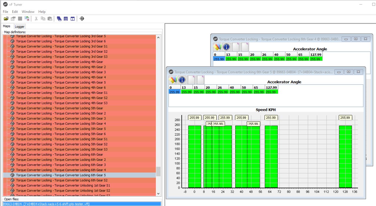

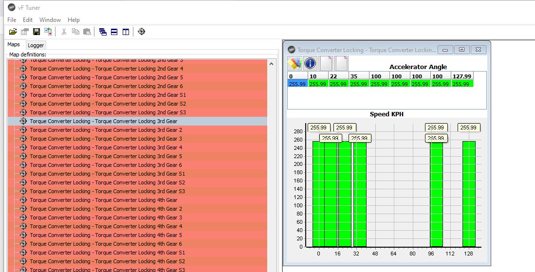

    finding more anomalies... 04B04

    What do the tables look like for TC lock 4th, 5th, and 6th?
    I ask because maybe in those scenarios, the TC doesn't/isn't supposed to lock.

    Legitimate speeds... 30s 40s 50s etcetera. Not 200+

    I'm wondering if those other situations it's just not supposed to lock in, but that's only a guess.

    This is correct. Some of the tables allow for lockup, some do not. By making the speeds 200+ the ecu ensures it does not lock up.
    How the ecu decides to follow a table that allows it to lock up, vs one that does not, i don’t know.
    @Mooseditty17

    Those are correct. Those values make sure it never locks in those gears / situations
