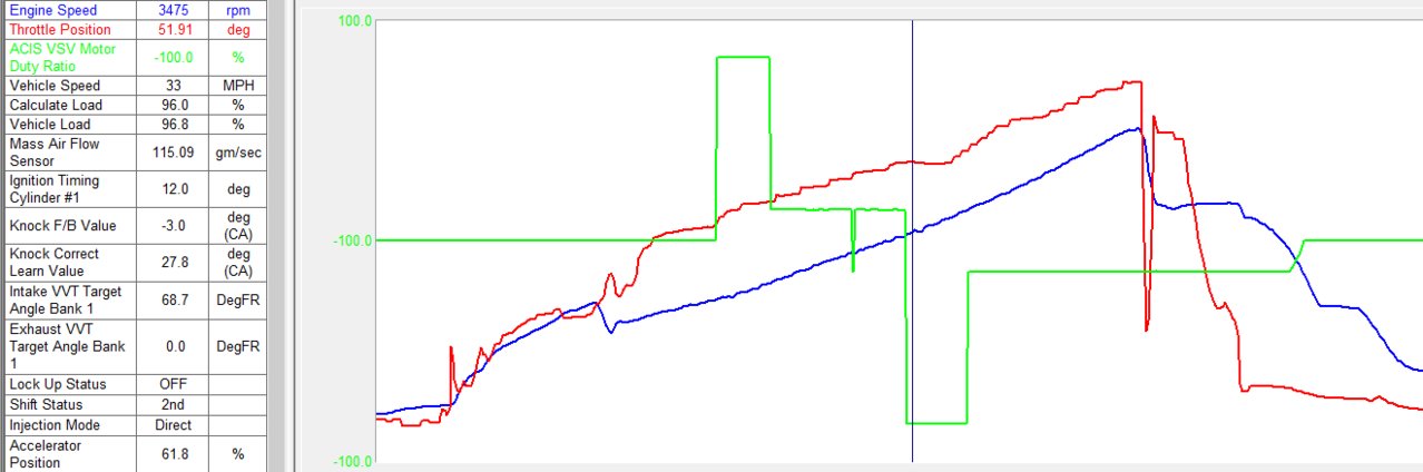

    Here are my ACIS values and a log I did earlier today. Cant quite decipher what is happening between the low and high range on the ACIS tables but moving the HIGH ACIS RPM down to 3400 definitely smoothed out the turbo.

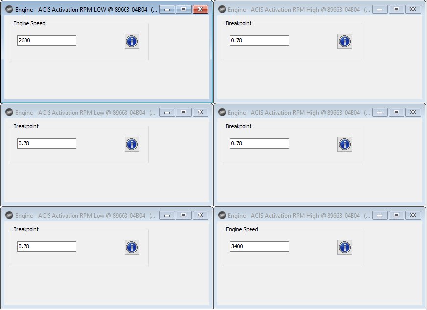

    You do not need to change the bit activations for ACIS, (25600, 0.78). Don't change them

    Based on the 04B04_Reg_Stock_Thx_33 base tune. Modified the ACIS: 3400 High, 2700 Low. FIXED THE ACIS MISHAP (see next few posts) . Air-load control maps have been smoothed, Acceleration Throttle Request map (3D) values were increased and smoothed. An the first 6 Throttle management tables (2D) increased.

    I haven't noticed any negative side effects from having changed those odd values. Should we put them back in, or is it ok?

    You too got rid of those strange values, you notice anything negative from doing so? OV just posted to leave them alone.... :annoyed:

    The values, are just a single byte that represents the individual binary bits that control when and what conditions ACIS is opened at the RPM points (low, high)

    So change them back?
    I don't want to share a sh*tty file...
    Like the last one I just posted that has the 25600.78 values changed
    If so I need to re-flash my truck too!

    I changed the 3rd AICS value back to 25600.78
    High is 3400, low is 2700, and rest are .78

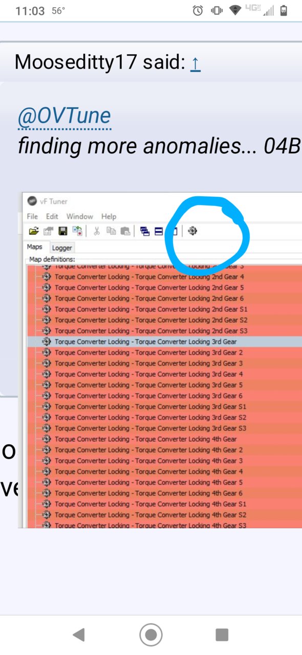

    Click the circle, not the open folder button. You can't "open" those files,(P5F) you can only flash them

    I don't want to flash. I want to edit a stock tune. How do you even view a stock tune? I can't read a 2.0 tune right?

    You have to download the .VFT tunes. Those are the only ones you can edit. The P5F are the same, but not able to be modified.
