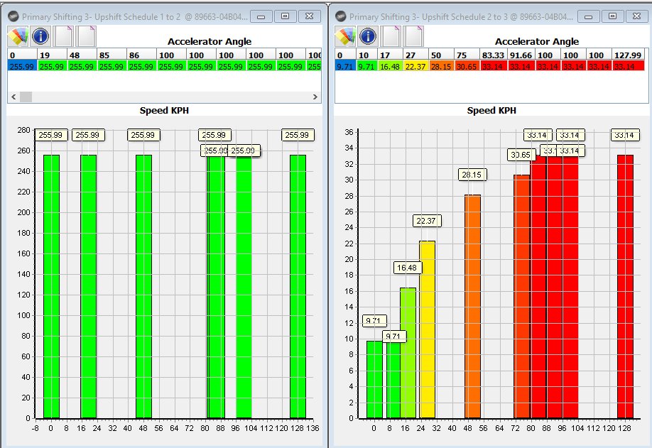

    I really want to know when each table is being used as well. So far the only one that remotely makes sense to me is the shift table 3 might be for 4 low since all of the shift points are very low and it locks out the overdrive gears from being used. I’m gonna try and do some testing on these maps to see when each one is used.

    If im reading the upshift tables correctly on the #3 shift map, basically at any speed regardless of pedal input it will upshift to 2, and then upshift from 2 to 3 anywhere from around 7+ mph, and 3 to 4 from around 15+ mph. That seems insanely low for any 2wd/4wd driving. It's been a while since I used 4low but it seems to feel like how the shifting actual works?
    What I plan on doing is modifying one map at a time locking out upshifts to 3rd or 4th gear and doing some neighborhood cruising. Hopefully I discover that only 1 or 2 maps are used... Will report back!:bikewheelie:

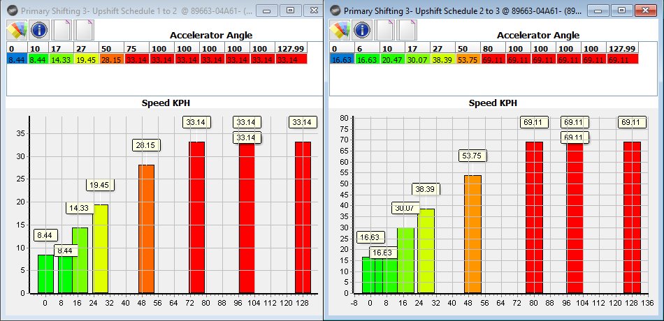

    I just checked my shift maps #3. Identical to map #1. 04A61 stock file.

    Here are what my first two upshift tables look like. Do you have any that match this?

    No. All 7 of my stock maps look like this:

    Interesting. My diff size is listed at .80.

    there's a couple weird things that don't make sense. Hot idle park and drive on mine are labeled backwards. A couple downshift points seemed backwards like 2-3 was higher than 3-4 on one table. I'm pretty happy with my tweaks for right now. Gonna let them settle for a while and hope for a performance map to play with or ECT map switch to tow mode function

    you likely need to update vF Tuner. this was fixed a while ago
    For anyone that may have a map error / something doesn't look right, make sure you're on the latest version (download button on our website front page)

    That was it.
