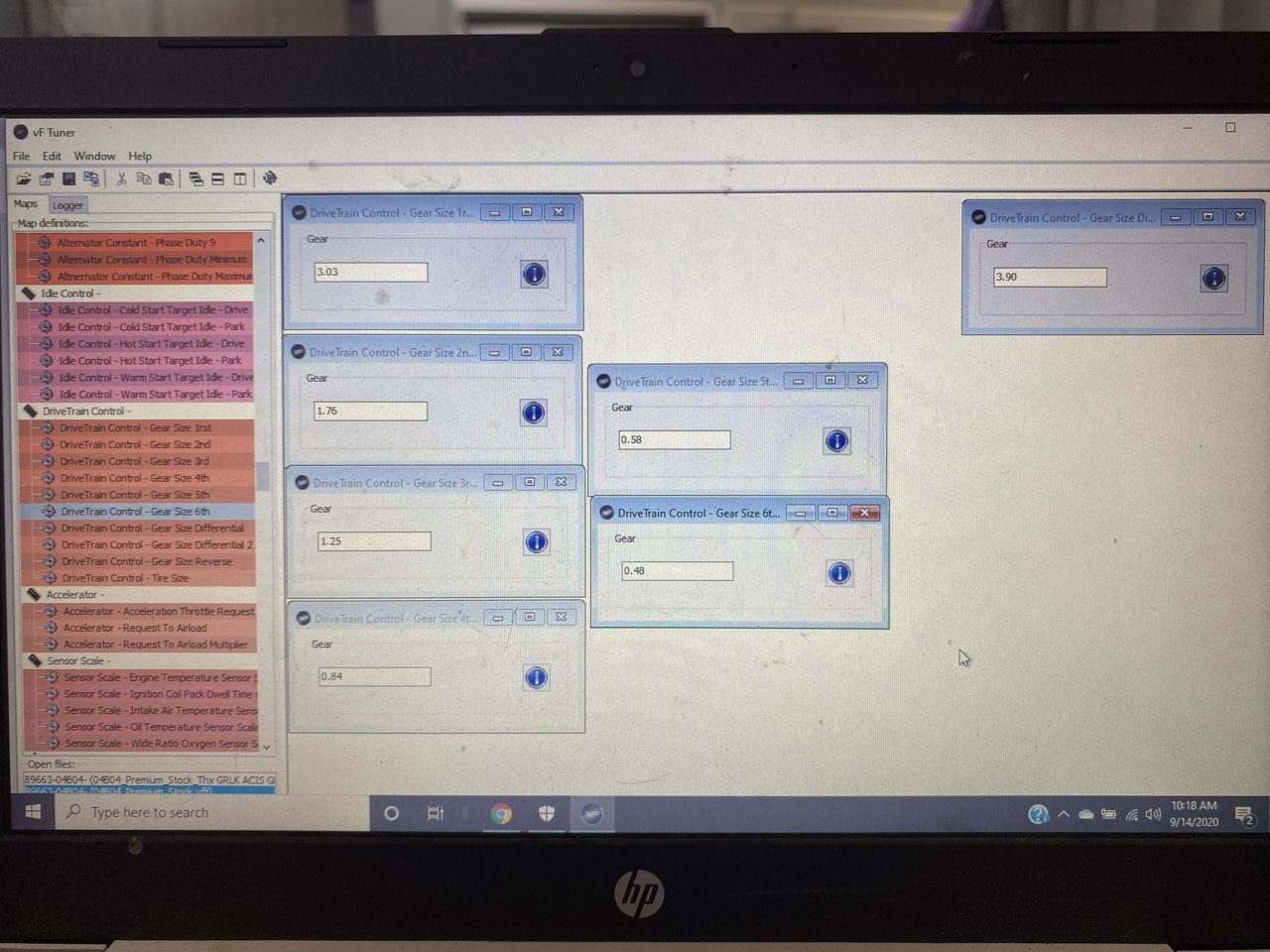

    @OVTune ,or anyone else, I was also noticing that the gear sizes under drivetrain control don't match the ratios for the truck.

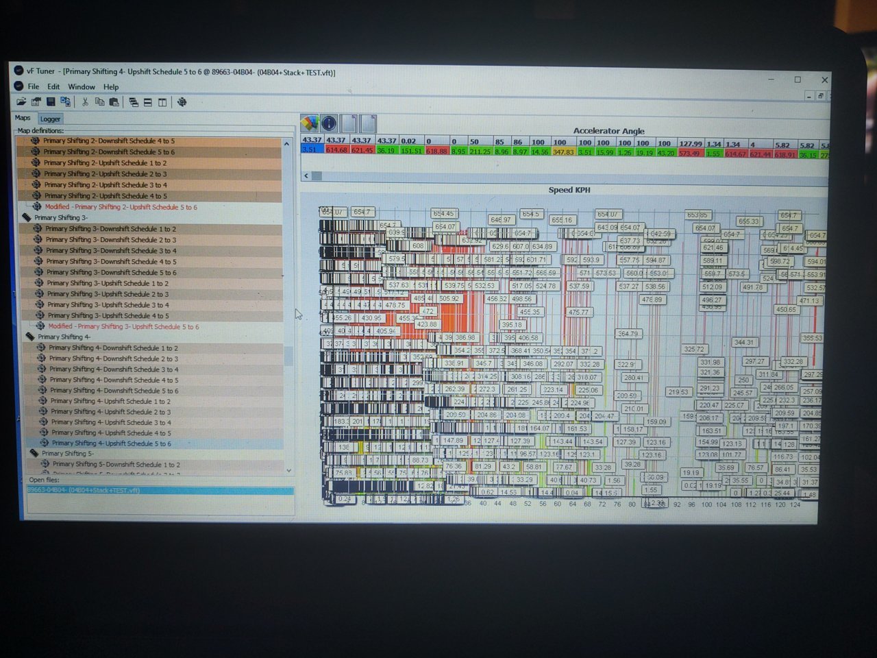

    Hold on... If looking at a shift map:
    upshift 4-5... That's to determine at what speed it shifts up to fifth gear from fourth gear. The downshift map 4-5 would determine the speed it shifts down to fourth from fifth. Correct????

    Take a look at drive control gear size......not sure if it's gear size or ratio......but it's not the ratios that the truck have. May be why the MPH where it upshifts is off.

    The same numbers on stock/4.88/5.29

    That's seems correct based on what I've tested so far. For each upshift table I believe it is the area ABOVE the curve where it will trigger an upshift. Such as in 2-3 gear up-shift tables if you are traveling around 30.07 mph(?) it will upshift if your pedal angle is between 0 and 17%. Hence as you increase pedal angle and keep speed it will not upshift.
    Opposite goes for the downshift tables.The area UNDER the curve will trigger a downshift. As you increase pedal angle and keep speed it will downshift.

    Just d/l latest version.....still there on your file and 04B04 premium stock file

    Im working on that. I will let you guys know. For sure this week.

    @OVTune should the values under drive train control 1st,2nd, etc gear size match the gear ratios our trucks have?

    So I updated VF and the diff ratios are correct now at 3.90 but the gears are all still off

    Are you certain those numbers aren't compensating for tire size or something?

    They are the same on all the files.....stock, 33's, etc

    Gear ratios will be corrected,
    any shift map error will also be corrected.
    new vF tuner will be available very soon, including some other things as well.
