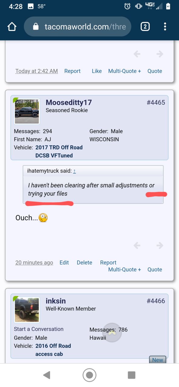

    When making moderate adjustments to a tune file can you benefit from NOT clearing LV and AT values?

  11. Sep 15, 2020 at 8:12 PM
    #4451
    ihatemytruck
    ihatemytruck Smartass
    Jul 26, 2013
    #109078
    1,636
    Dave
    Southern California
    '17 Tacoma 4x4 off road DCLB
    I haven't been clearing after small adjustments or trying your files
    inksin likes this.

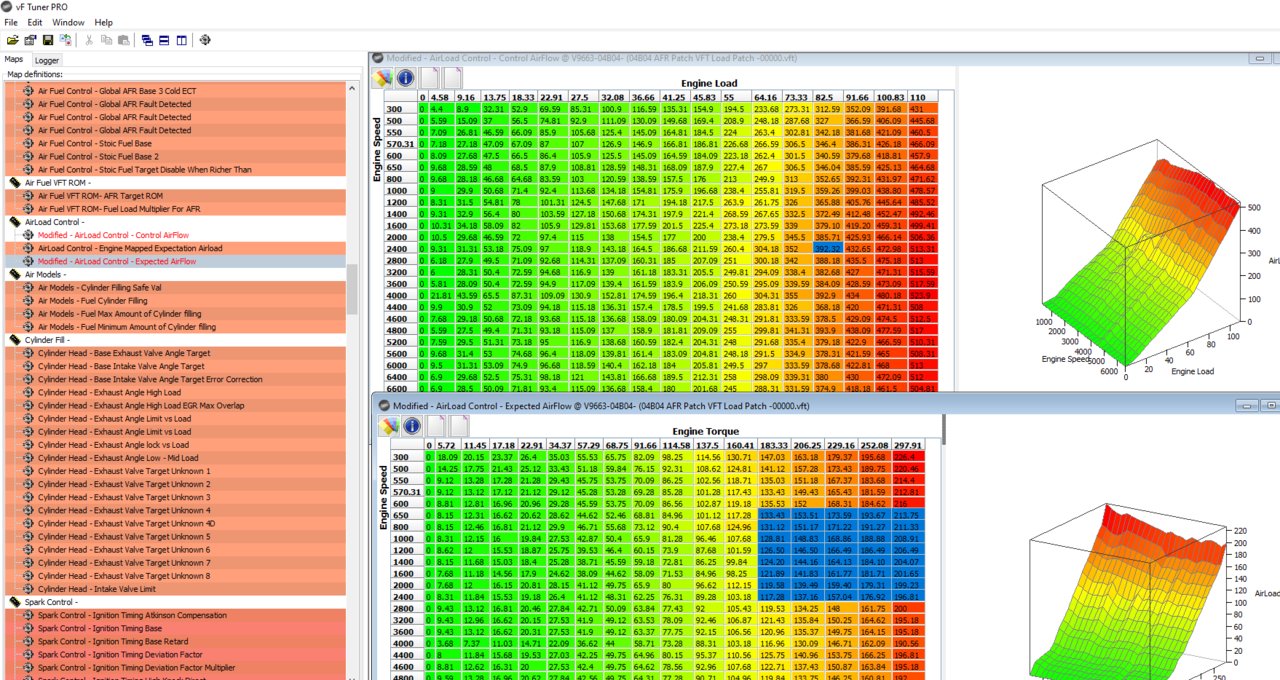

    This is probably going to look like a cluster f@@k but here is the dip im referring to on a techstream log. If you can interpret this, the small red circle shows a dip in RPM just after the up-shift RPM dip that feels like a double up shift. The bigger red circle shows ignition timing drastically retards and becomes inverted compared to the the trends to the left of it where I'm accelerating at the same pace. My pedal input doesnt change, the throttle doesnt change, TC doesnt change. Some very odd anomaly.. FYI this was on a very slight incline with no grade change while I was accelerating.

    Woot! I just tossed this patch on top of the air load edit! Only 10min in, but VERY nice!
    Thank you for punching the one up.
    :cheers:
    I'll post up more with more realistic miles.
    b3itz and inksin like this.
  14. Sep 15, 2020 at 8:40 PM
    #4454
    tonered
    tonered bartheloni
    Sep 25, 2017
    #231055
    31,191
    tony
    Lynnwood, WA
    Hey, @OVTune .
    Thanks for this! Just combined it with the linear throttle edit. It feels very nice off the mark.
    This was my first vF edit and was a lot easier than I was imagining.
    The CRTL + I smoothing is pretty aggressive! Without Undo / Redo functions, it threw me off. Then, I realized that just closing the current map gives me the choice of at least clearing the changes.
    Thanks again! :cheers:
    I'll post up more with more miles.
    xxTacocaTxx and inksin like this.

  18. Sep 16, 2020 at 2:07 AM
    #4458
    Mooseditty17
    Mooseditty17 Seasoned Rookie
    Apr 7, 2019
    #289395
    1,681
    AJ
    WI
    2017 TRD OR : M+W Nexus Tuned
    Tune: Nexus +P Add ons: +3" custom suspension 295/70/18 Yokohama M/T Tires KMC XD Grenade OR wheels KN intake Blackhawk MBRP Exhaust TJM Rock Crawler Bumper Lighting (+10 H.P.)
    Ouch...o_O
  19. Sep 16, 2020 at 2:21 AM
    #4459
    inksin
    inksin Well-Known Member
    Sep 1, 2016
    #196160
    895
    Hawaii
    2016 Off Road access cab
    ouch?
    I don't clear before running your files either. My truck runs all kinds of shitty for a good 50 miles after resetting values so it's hard to notice the fine tweeks in throttle settings and stuff if the truck is running like a potato. Targeted changes of certain things would be easier to butt dyno without the whole system relearning everything I'd imagine
  20. Sep 16, 2020 at 2:29 AM
    #4460
    Mooseditty17
