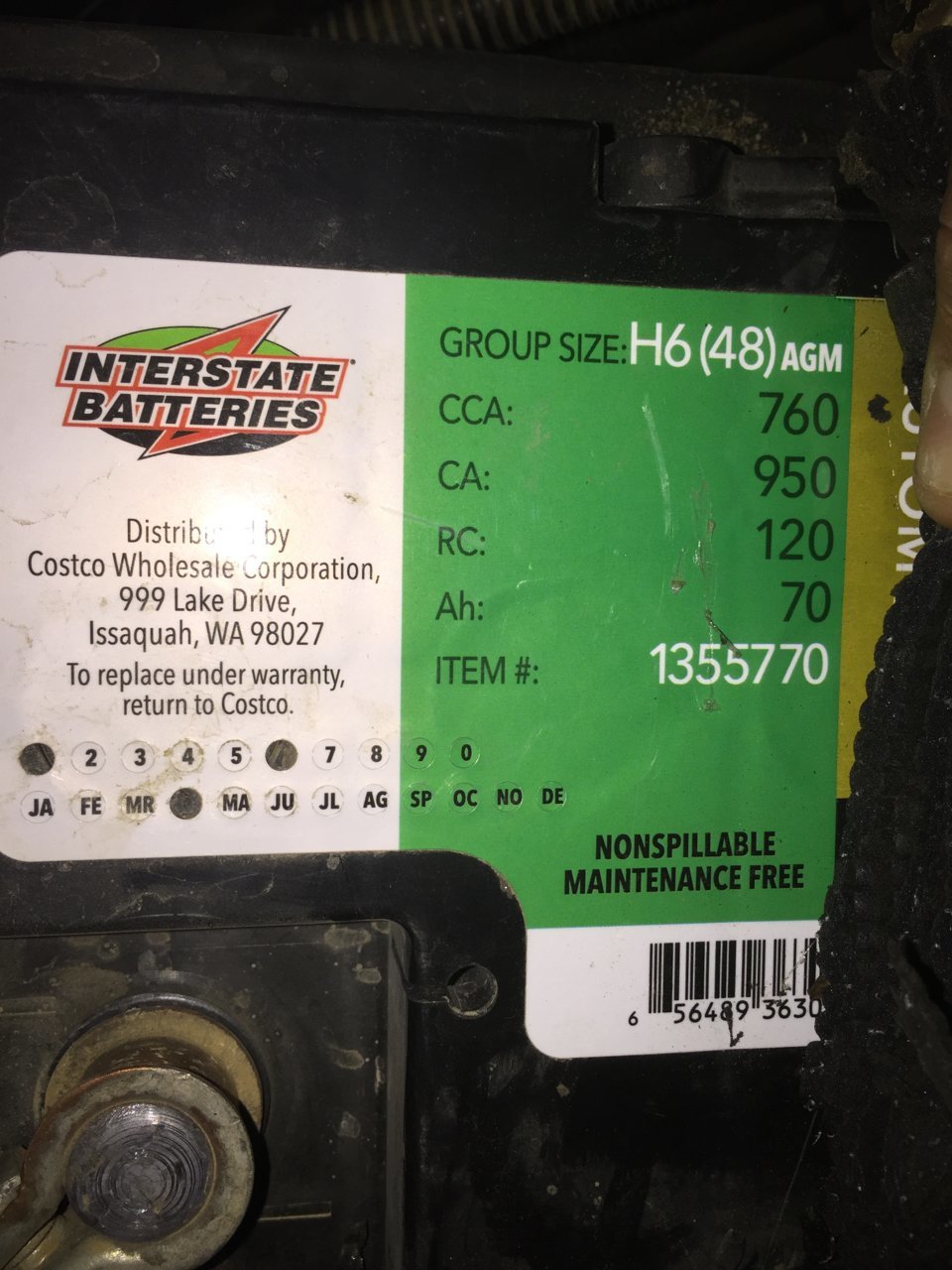

    So you went up 20% over the modified duty cycle settings in that post or over stock?
  2. Sep 16, 2020 at 10:29 AM
    #4502
    Shellshock
    Nov 21, 2015
    #170338
    23,599
    Iowa
    Over stock
    I left phase duty 1 unchanged. All the rest +20%

    I just checked my battery it’s at 12.52volts
    I up the duty to 96 and drive around a little and check again
  8. Sep 16, 2020 at 11:23 AM
    #4508
    Shellshock
    Nov 21, 2015
    #170338
    23,599
    Iowa
    These are all the tables i modify (stock values shown below) for AGM changes
    If you ONLY modify the “base phase duty” your output is going to be lower than you may expect, or you’ll have to raise it higher to get the output you want.
    If i set base phase duty to 94 and up the duty cycle +20 (max of 102.3) on duty 2/3/4/5/6/7/9, my output is at 14.5v. I’ve been running this since June 23 without issue.
