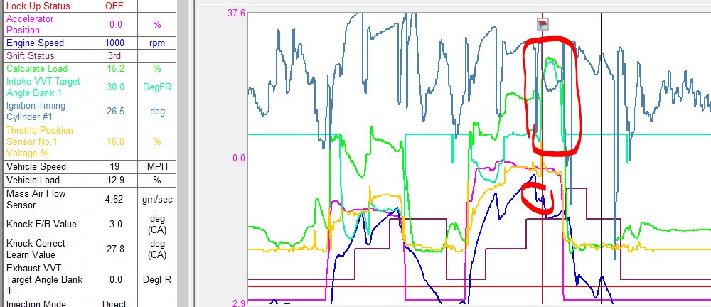

    From 20° it redards to 5, Intake VVT swings to 59°, IG dips to 1.5° then recovers to 17°and it is consistent between all the events. Is it related to IG timing compensation for Atkinson cycle?

    I am looking at your graph. It looks like the calculated load spikes at the same place intake timing spikes and engine rpm drops. That all makes sense to me. The question is why is load spiking here?
    Edit: i guess i don’t know how load is calculated. Maybe the engine is calculating higher load because rpms are dropping. I hope my speculation isnt getting in the way I just find this interesting.

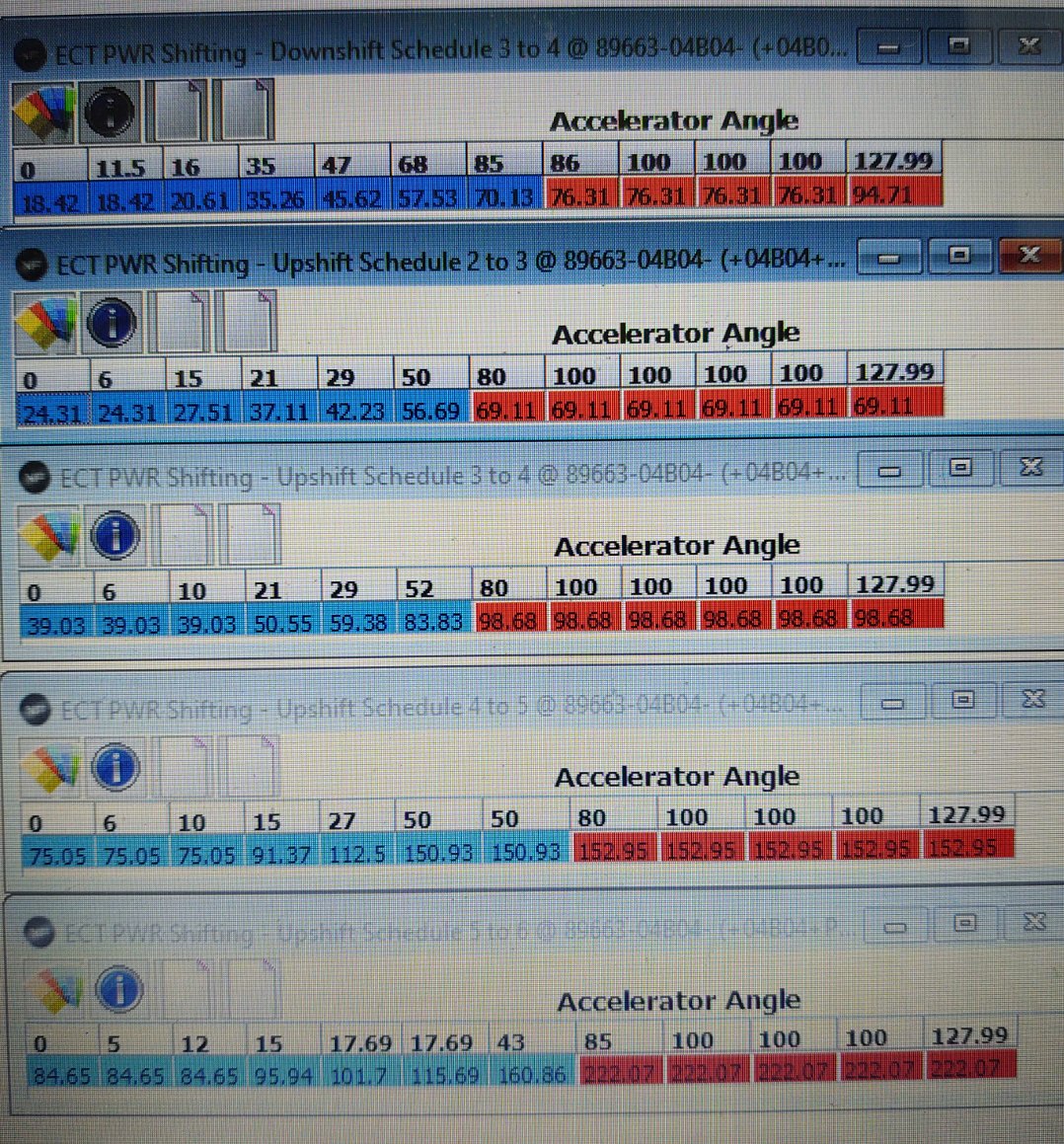

    I've been toying with the ECT shift points with some advice from @ForceOfG. Those tables seem to respond appropriately. It gives you a taste of what your going to have to dive into later.
    ECT - 10 tables... Primary shifting - 70!
    Plus you can switch back to "normal" with the push of a button!

    I can post the tune tomorrow after work. I can also share a screenshot of the shift points tonight. :D
    Again, shout-out to @ForceOfG for helping pull me out of a mental rut on the comprehension of shift points :thumbsup:
    I personally like the way my truck tows from a stop up to 4th gear in ECT mode. Afterwards it tends to try and grab 5th, and more often than not, it ends up bouncing back and forth. Drives me :annoyed:. Also on some of the less extreme inclines I frequently traverse, I felt it dropped to 3rd too easily when it should have held off another second or two and made the hill in 4th. This is my attempt at a solution. Unloaded it does exactly as I want! I have yet to test it with the camper. Ultimately that's my heaviest load, and if it tows that well, it'll tow everything else I got beautifully. ATVs, boat, etcetera. This will be the same tune as the most recent Perf+2.5 but with the ECT PWR shift points shown below, added to it.
    (2-3 upshift table is just there for visual. No adjustments made to that table or other tables that are not shown.)
    Note: I have 33*11*18 with 3" lift, Steel front bumper and stock gearing. With my everyday gear in it, my truck weighs approximately 5000# per my local scale.

    I believe load is dependent on a couple things. Throttle angle, RPM, MAF all contribute to the calculated load. But it my interpretation load is the % of the max amount of air your engine is able to suck in at that RPM. I've also seen people saying it can basically be treated as the % of available torque that you're making at a certain RPM but with our trucks using Atkinson I don't think that idea is applicable for all situations. But yes the load spikes because the RPM takes a dive. Should the load spike that much? No idea! In my mind if throttle angle is 20 and RPM is 1500, load should be the same regardless of gear. Hopefully someone can educate us a little more if that is incorrect.
