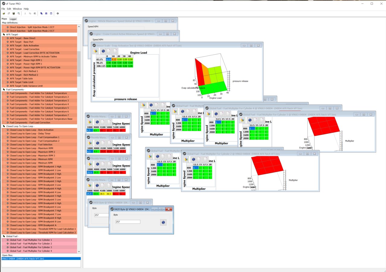

    Tables being released tomorrow include:
    Evap Active - test map for Evap purge solenoid (the think that obnoxiously clicks at idle)
    per cylinder fuel multipliers
    0420/0430 bytes set zero (for DUMP TUBES)
    Vehicle speed limiter
    Cruise control minimum speed activation
    all throttle limiters for 1rst / reverse
    some of these tables were very difficult to figure out!
    Please don't post the vehicle speed limiter table online, some of our competition is trying hard to find it!
    - throttle tables updated with correct scaling vs last image

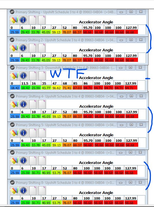

    When tuning the primary shift points... Let's say I raise the upshift values on 5-6 by 10% on the first table, I then need to do the same on the 6 other tables, correct?
    And is it necessary to increase or decrease torque converter values to correspond with the new shift points? Or are those tables just to tweak the torque converter even further than what you changed the shift points from?
    @OVTune ?

    Why aren't all the primary shift points for the same up shift schedule the same? Should they be?

    Can anyone shed some light on this? Is this already being addressed in the update tomorrow, or is this oddity accurate?
    tables 1 and two have same gray values. 4 and 5 same values but different that 1 and 2 and then 6 and 7 share same gray values but are different than 1 and 2 and 4 and 5. Seen this quite a bit on tables... also, why are table 3's editable values so much different than the rest? :boom:
    Edit: This is embarrassing. :rolleyes:

    Table 3 you selected is a DOWNSHIFT table, all others are upshift.
    The other tables are dependent upon very specific mode / conditions in the ECU, mainly limp modes. Those sets rarely need adjusted, but for clarity you can just make all shifting the same as the first / main primary shift tables

    Wow!
    Clearly I need a vacation...
    Thanks for pointing out the obvious. I appreciate the clarification as well. I think I'll go to bed now.

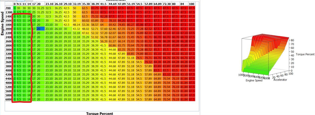

    Alright so I unlocked everything i thought possible and felt comfortable messing with and still getting throttle limits:ballchain:
    -2nd gear limits to 40% and then jumps to 80% at 2500 RPM.
    -4th gear does the same.
    -5th gear limits the same but limits to 80% once at 2300 RPM.
    -6th gear never got above 27% but I was only able to get to about 1700 RPM due to where I was testing.
    Can anyone who's confirmed removed limits on the auto's provide some insight on how they did it?

    Throttle limits can be removed in the new version of vF being released tomorrow
