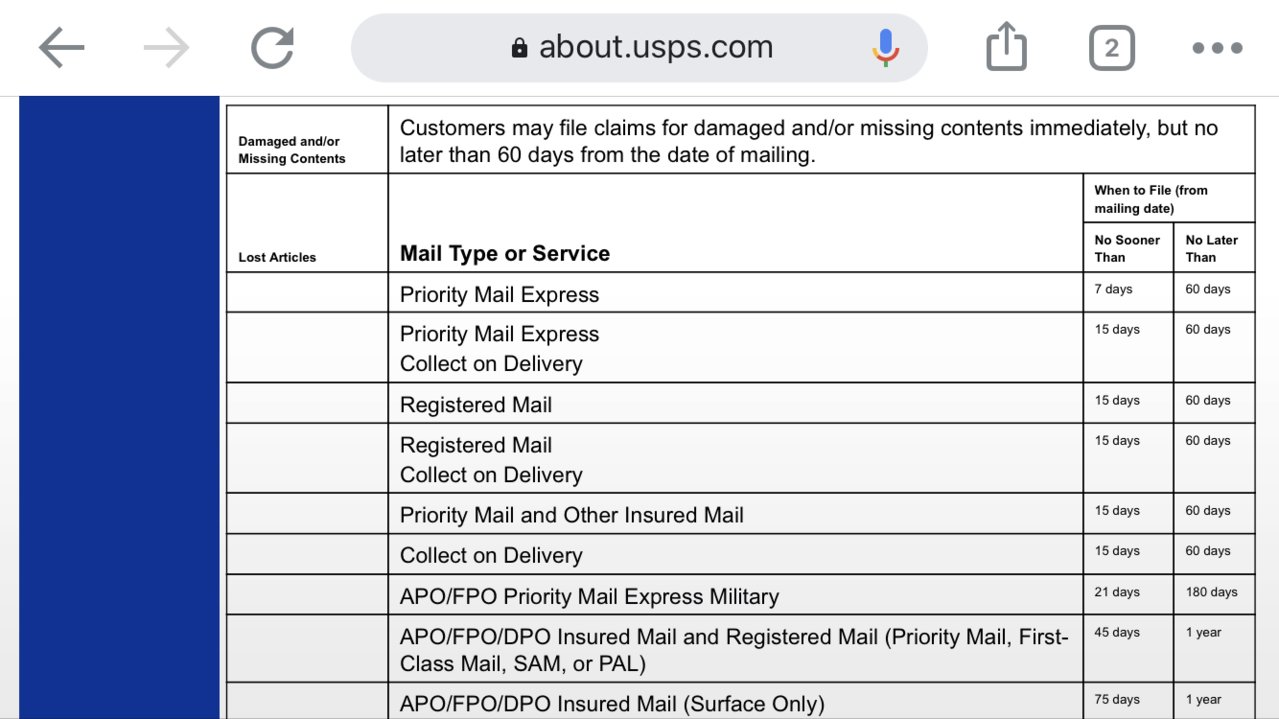

    Although I’m bitching about it, I understand the limitations and remain a supporter. My only legitimate concern is the lack of traditional comms via email indicating receipt, since USPS priority insurance claims must be made between 15-60 days.

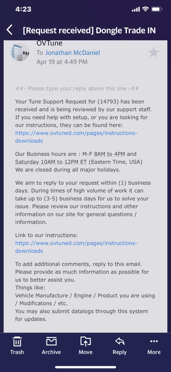

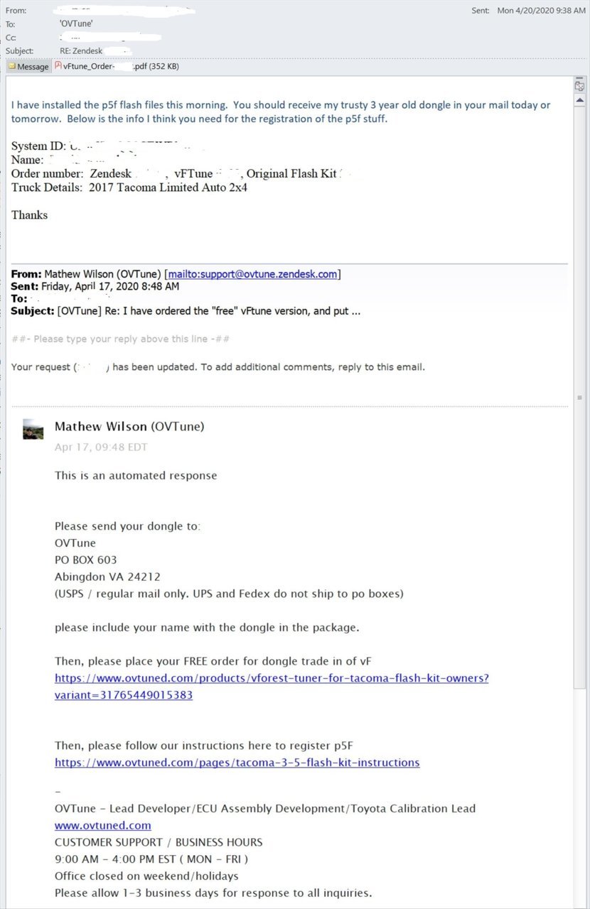

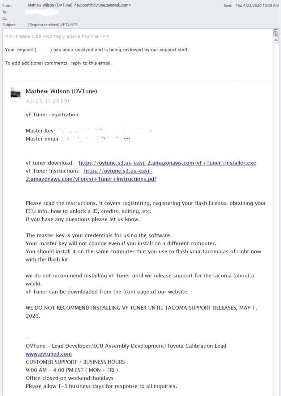

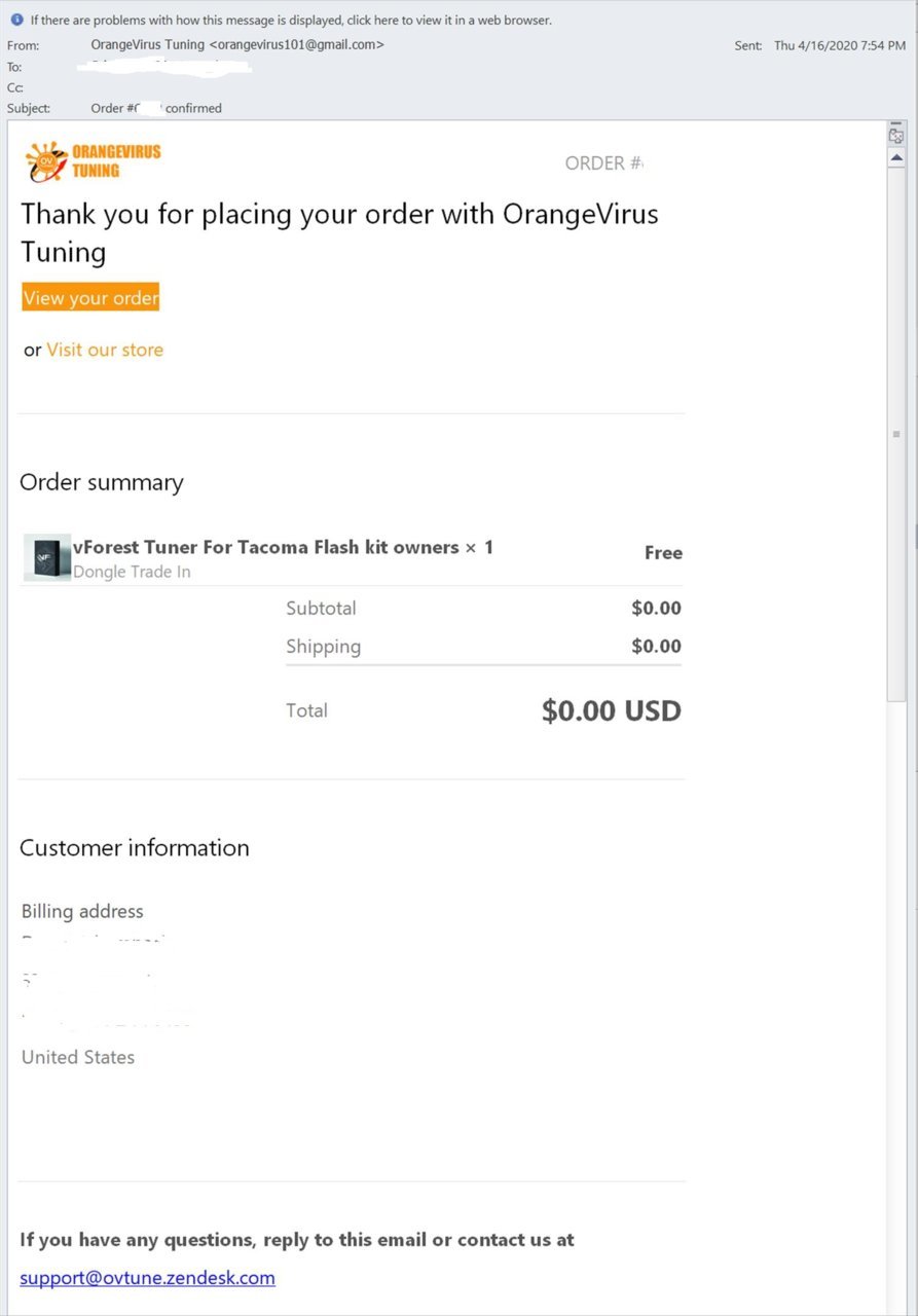

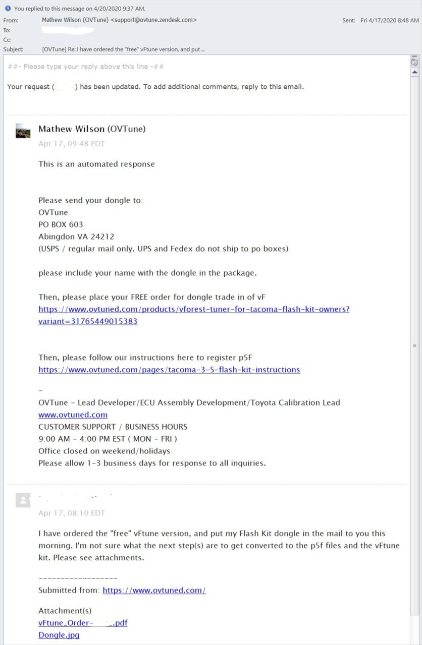

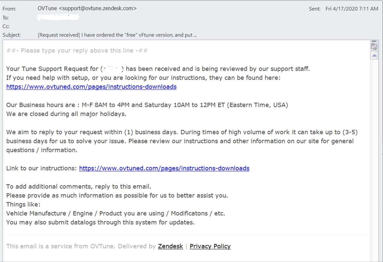

    This is what I did to go from ordering the "free" vFTuner, returning my 3 year old dongle, and actually receiving all of the authorization keys I need to run the vFTuner software AND the p5f Flashing software. I have attached jpg images of all of the emails I received from OVTune and Zendesk in the process. I think I have blocked out all of my personal info and order numbers and key codes.
    Step 1) On 04/16/20 I ordered the "free" vFTuner package from OVTune website. I received the confirmation email (jpg file starting with "1") that same day.
    Step 2) I opened a Zendesk ticket stating that I placed the order and asking what steps were next. I attached a jpg of my order and of my dongle, and listed my original dongle order number from 2017. I figured too much info was better than insufficient info. THIS WAS THE ONLY TIME I EMAILED ZENDESK, EXCEPT FOR SENDING SYSTEM-ID SEVERAL DAYS LATER.
    Step 3) On 04/17/20 I received email reply (jpg file starting with "2") from Zendesk as an acknowledgement that my Zendesk request had been received and would be responded to.
    Step 4) On 04/17/20 I received email reply (jpg file starting with "3") from Zendesk with instructions to return dongle. I mailed it by regular mail (with two stamps) the same day.
    Step 5) On 04/20/20 I replied (jpg file starting with "4") to the 04/17/20 Zendesk email with my System ID from the notebook I use for Flashing.
    Step 6) On 04/23/20 I received email reply (jpg file starting with "5") from Zendesk with my vFTuner Master Key.
    Step 7) On 04/29/20 I received email reply (jpg file starting with "6") from Zendesk with my p5F Flashing Key.

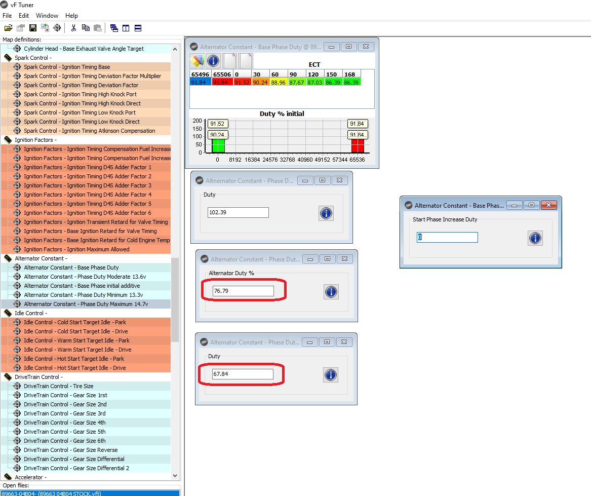

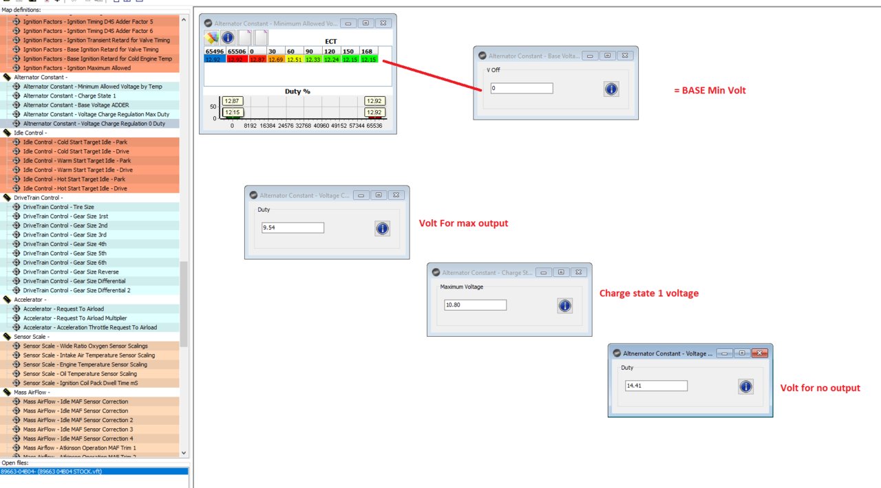

    Okay,
    so after digging through the code further, I think I was correct the first time.
    There is a Base Phase Duty for the Alternator
    This is the initial Duty required on start vs temp
    Then there is an initial Duty % adder (start vs temp + adder)
    Then, there are 3 Phase charge duties.
    13.3v
    13.6v
    14.7v
    To increase your voltage
    increase your minimum and moderate phase duties.
    if you want to increase your on-start duty, increase your duty adder.
    Do not increase your duty past the stock maximum 14.7v
    Do not increase your duty past 102.35%
    increase your phase duties *moderately* until you see the charging voltage you are targeting.
    download link on our website, or this link here:
    https://ovtune.s3.us-east-2.amazonaws.com/vF+Tuner+Installer.exe
    PNWTacoma, Karminski, JustDSM and 3 others like this.

    Gave it a test, but unfortunately these did not net any gain. I initially tried increasing both the 13.3 and 13.6 value by about 9 each and didn't see any increase. I then took the 13.3 to 95 and the 13.6 to 101, and again no increase. Flashed back to the stock values.
