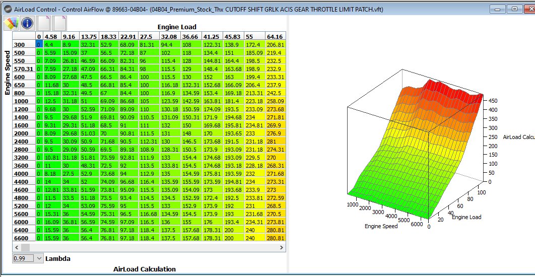

    I guess I'm getting mixed info, Matt said yesterday that its already possible. I believe whats coming out tomorrow is limits for 1st gear/4hi/4lo not for the gears I'm trying to unlock which sounds like is already possible.

    In 6th at 1700 rpm the motor can only take in so much air. It may only be opening that much because there is no difference in the amount of air coming into the engine whether it's 27% or 100%
    If you were turning 3 or 4k rpm then it would probably open more, but then what speed would you be traveling?
    Edit: i understand that you want to remove all limits so it's more like cars of yesterday, i do as well

    sounds like you need to modify your airload control, airload expected tables

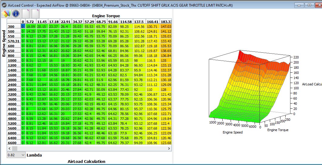

    Mat @OVTune , quick question..
    Other than removing throttle limits, can you give us the Cole's notes on what exactly we're messing with in these four airload tables?
    Some of us have been doing a little more than smoothing 800-2k like you showed us lol..
    AND, with the new throttle limit tables you mentioned, will modding the air load tables even be necessary?

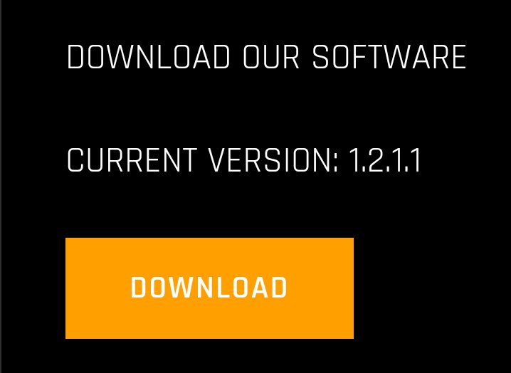

    Currently having 1.2.1, we just go to OVTuned.com and click the download button once the description changes to 1.2.5 and carry on our marry ways? Will the old version just be overwritten? Should we uninstall the 1.2.1 before installing 1.2.5? I'm new to your software so I've never updated before. Please advise best method.

    When the new version releases, it will say that version "CURRENT VERSION: xxxxx"
    and then it will also show the version in the "about" in vF Tuner
    just download, and install. It will install over the previous installation.

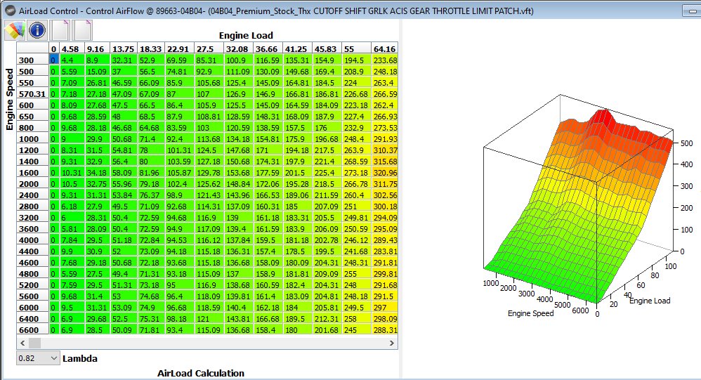

    I'm with ya I think the limits are there for a reason. But after seeing how much Toyota neutered our trucks I'd rather just see what happens when I unlock it. 2500 RPM in 6th would mean im doing about roughly 100 with stock gears :burnrubber:
    And I also modified 'airload control' - control airflow and 'airload control - expected airflow' but i guess not to the extent I should have? Cant seem to find a table that replicates throttle being artificially limited to 40% up to 2500 RPM and then releases to 80%+ after that. Here are the tables I'm currently running. Any insight on how to fully unlock it would be much appreciated but I'm going to keep testing as well.
