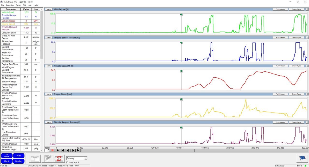

    Did a quick data log after adjusting air load tables, primary torque target table, setting throttle limits to 100, and setting ACIS High activation RPM to 3400. I never saw the throttle open more then 82.5%.
    I also did a log at lower speed but guess I didn't save it. Disclaimer still new to logging....

    82* is the allowable limit of the throttle, so sounds like it is getting full throttle.
