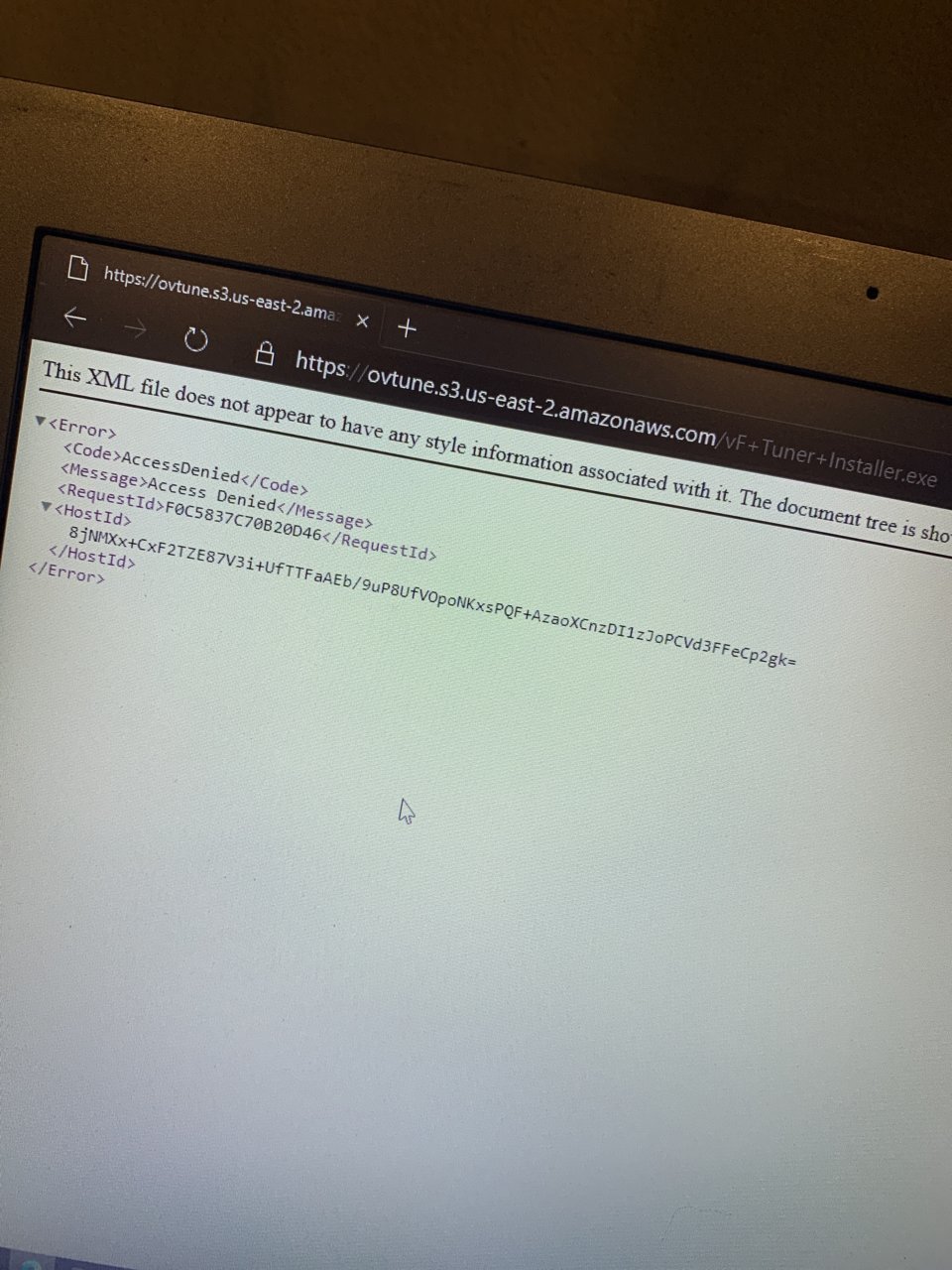

    #4629
    Tac0Tic0
    Tac0Tic0 новий член
    Sep 26, 2018
    #267519
    1,098
    SLC, Utah
    17 TRDOR QS
    OVTune Volk TE37XT 17x8.5 295/70r17 G003 Yukon 5.29 differential gears Cab Mount Relocate Icon Coilovers Icon AAL Uptop Overland Bed Rack Maxtrax Baja Designs Squadron Pro Ditch Lamps Rough Country Speedometer Calibrator
    Am I the only one? Tried several browsers
  10. Sep 18, 2020 at 10:34 AM
    #4630
    OVTune
    OVTune Well-Known Member
    Mar 27, 2017
    #214557
    8,112
    OVTune
    give it 5-10 mins, you guys are hammering it with downloads right now
