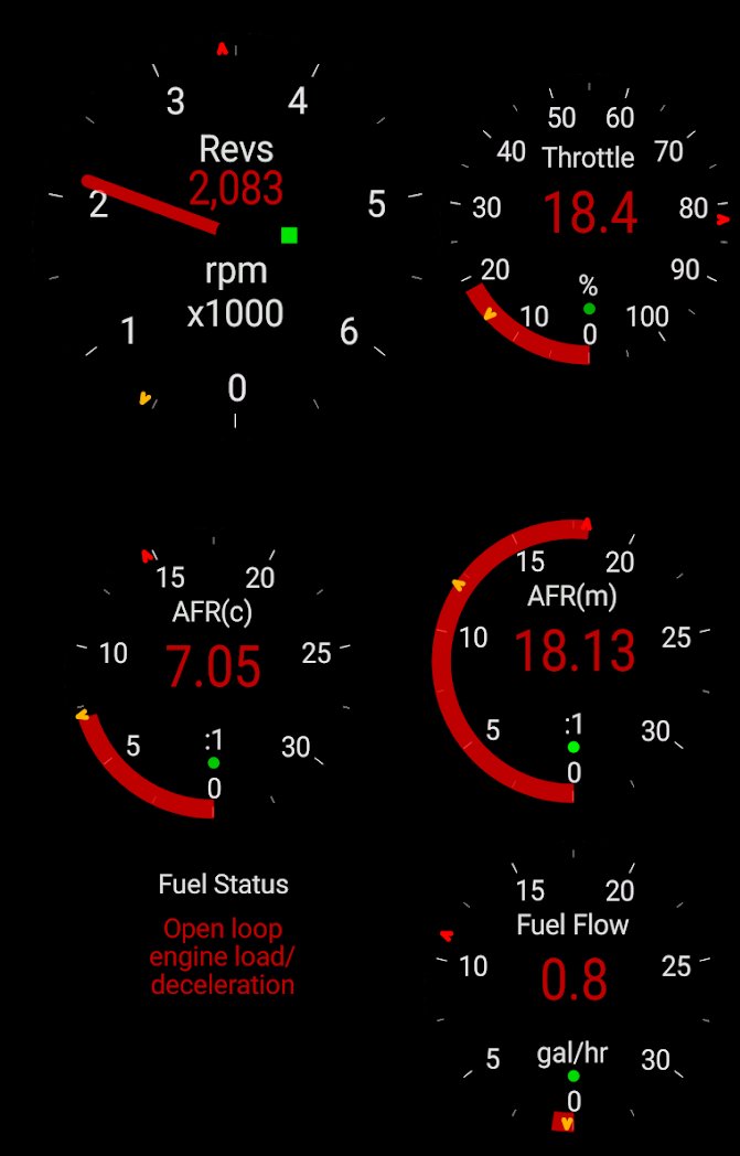

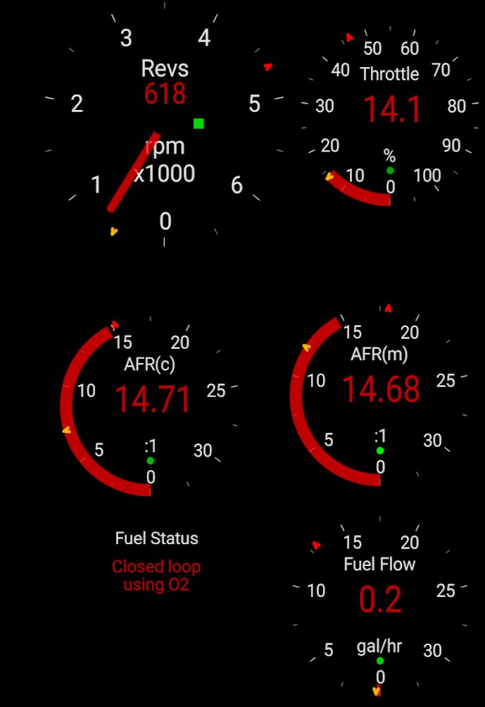

    Just some wavy throttle response and the CC is bucking going downhill like it did Stock, but more pronounced. It is certainly not excessive, just could be better.
    Comparing the Air Control maps, idle and low torque was not messed as much as the Throttle map. The values changes aren't huge, but it might be a 5% problem?
    What I am noticing is right around 2k in any gear and super light throttle. The big question is what is the throttle % at and is it a direct correlation with the % in the map? If so, I know the throttle runs at about 17% stock.
    These are both on what should be 1.05 FOB, maybe Base?, when coasting:
    MOC221_[QUOTED] likes this.

    I don't have enough km on my latest file to say with 100% certainty that I'm not experiencing the same thing. I have some driving to do tonight and over the weekend and will pay attention to the scenario you describe.
    I will say that even with straight up 04B41 SFOB Premium, there is a point when coasting that the engine is a bit twitchy, like it doesn't know whether you're at full lift or a tiny bit of throttle. It's not huge, but it's there.
    What you're describing sounds like more than that though.
    My intention with the Linear Throttle Mod is to decide where on the map that increasing the values will have the most impact on throttle blipping, while not adversely affecting anything else with respect to driveability.
    I might have to log some driving with focus on downshifts to have a closer look at what rpm/torque/load values pop out when I'm blipping. I'm thinking that it'll be in the 1000-2500 range (if you consider how much the rpm falls after you lift to make the gear change. This of course excludes more "spirited" driving, but we'll cross that bridge when we get to it.
    I'm going to leave a lot of that map alone to begin with, and look at changing a relatively small number of cells at a time. I may not do the LV reset during this process, as I see a number of flashes occurring to dial it in.

    That sounds like it. Basically, driving on level ground in 1st and try to hold a steady speed at about 2k. Most pronounced there.
    That is the wild thing. The Taco drives so nice above the light throttle. Shifts are buttery, up and down, and the throttle is all smiles.
    I haven't tried it, but it feels like it could roll nicely from a stop without touching the throttle.
    That could be a good plan?
