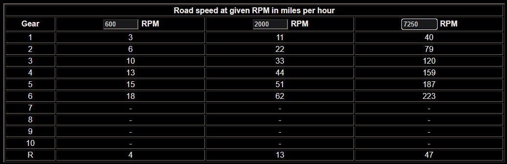

    How fast does 7250 in 3rd get you?
    Not sure I wanna know.

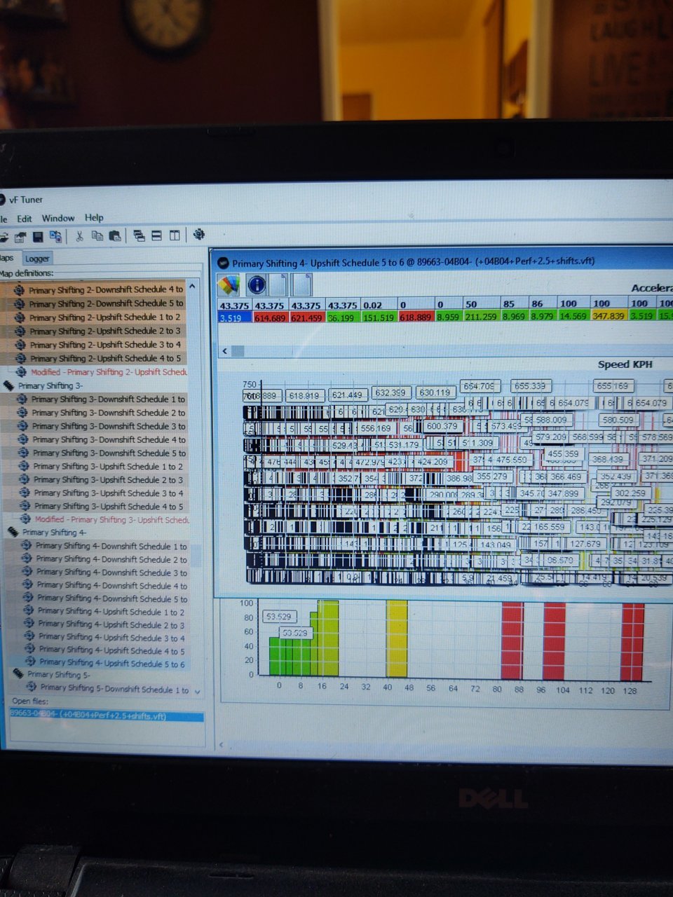

    FML. 04B04 primary 4: upshift 5-6 still inoperable @OVTune IMG_20200918_163639800_HDR.jpg
    Can I run this with the rest matching and this one f'd up?

    Southern California
    '17 Tacoma 4x4 off road DCLB
    Ya, I'm running that one on top the stock tire size, premium thx file......I haven't had it happen

    What happens if you change the values?

    Suggest
    Suggested files to change here? Normal 1-6 and the 1st gears minus 4 low?
