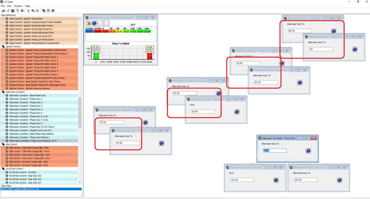

    With 13.3 duty set to 95, 13.6 duty set to 100, and then I set the 120,150,168 ECT temp values to first 90, and then 95. I'm fully warmed up and ECT is higher than those. Same results - no increase in charging voltage - still in the 13.71 to 13.74 area (slight fluctuations)

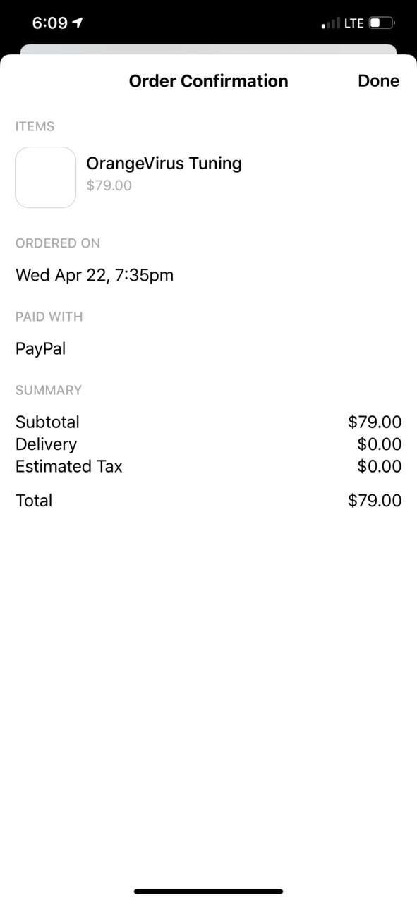

    is it fine to purchase everything from phone or do I need to purchase from computer I’ll be using to tune?

    Hmmm
    Ok I will dig back into the code.
    Really odd because the active test data matches
    I'll figure it out tonight

    pm me an order number, I cannot figure out anything from that pic.
    Purchasing from a phone is no problem but you need a computer to use the software.

    Okay. I've found several other alternator controls. Sorry guys but thank you for testing.
    The code section from the PID data pulls up only a certain section of a much larger code segment.
    Anyways all will be in the software tomorrow with phase modulations for each charge state
