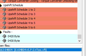

    Just loaded a slightly modified version of @Mooseditty17 tune. Tweaked it for AGM and did some additional smoothing to the air load tables. Just because... headed for some test drives. Usually run the premium fuel tunes but will see how this works and possibly make similar edits to a premium 2.0.

    Question for @OVTune can we over smooth or cause problems in using too much “CTRL+I”? What should we be looking for other than a nice smooth plot?

    I’m concerned by smoothing we may lose transition and go from green to red with little yellow and orange. So I tried to keep it generally close to stock in that regard, but just lose the peaks and valleys.
    @OVTune should we be looking for more even Green/Yellow/Orange/Red distribution? Any helpful hints or examples? Any risks or things to avoid?

    anybody else notice this??? Faults. At the bottom of the scroll list... what are those.jpg

    Wonder if that’s to eliminate CEL for the catless dump tube folks?

    Do you have them? I've never noticed them before and now I'm freaking out. If you also have them, I'm not so worried.
