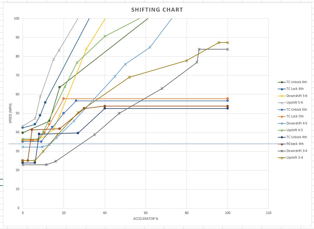

    Decided to graph all the shifting shenanigans with a spreadsheet to see if it would help fine tune the shifting... Yep she's a mess.
