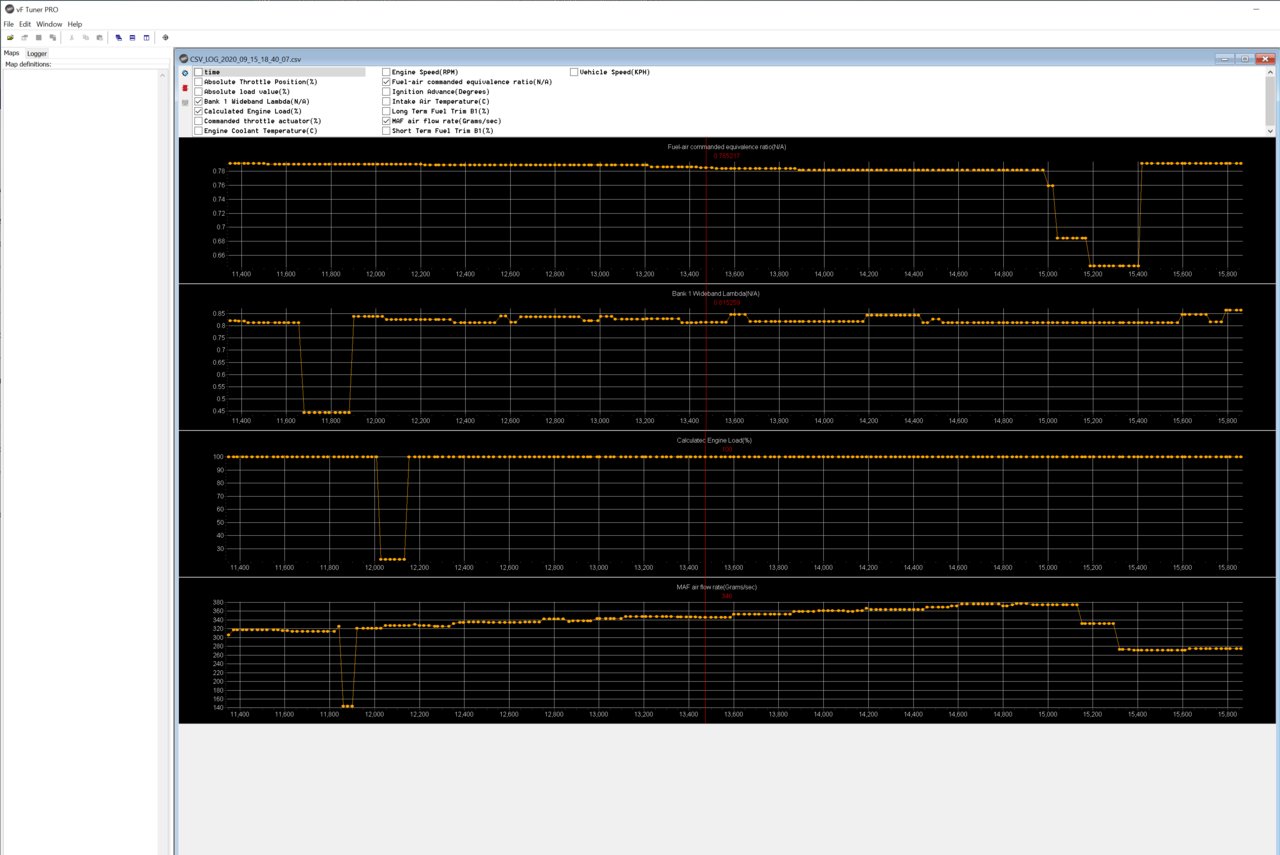

    OVTune
    OVTune Well-Known Member
    Mar 27, 2017
    #214557
    8,112
    OVTune
    new version will release with compare, axis editing, new graph view for datalogs, etc.

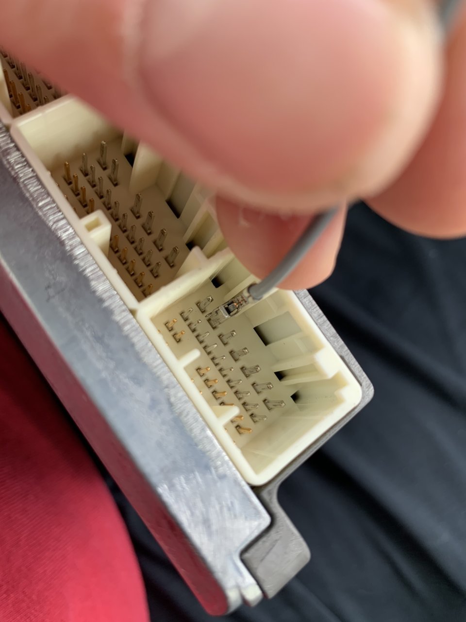

    Tac0Tic0
    Tac0Tic0 новий член
    Sep 26, 2018
    #267519
    1,098
    SLC, Utah
    17 TRDOR QS
    OVTune Volk TE37XT 17x8.5 295/70r17 G003 Yukon 5.29 differential gears Cab Mount Relocate Icon Coilovers Icon AAL Uptop Overland Bed Rack Maxtrax Baja Designs Squadron Pro Ditch Lamps Rough Country Speedometer Calibrator
    Bought an OBD2 repair kit from autozone. Fits perfect. Going to knock it out today!

    lapoltba
    lapoltba Full Bridge Rectifier
    Aug 28, 2014
    #137089
    3,344
    CT - 06076
    '17 Sport, ACLB, V6,MT, 04B14 OV-Tuned
    If the software doesn't recognize the ECU the first time, swap the two CAN lines.
    Tac0Tic0[QUOTED] likes this.
