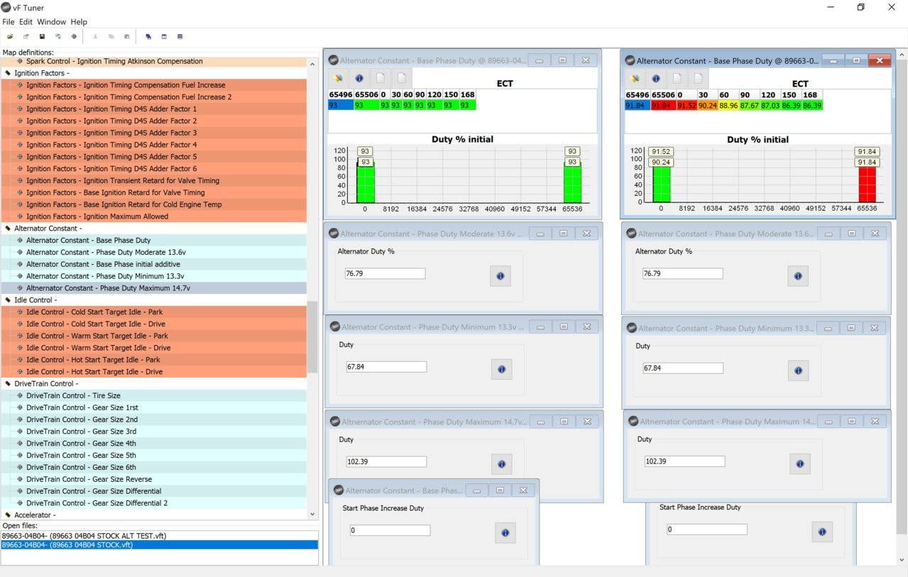

    I'm on babysitting duty for the next 3 hours so I can't go load this to test. However, the feedback earlier from you on having multiple files open is exactly what I was hoping for. Once additional tunes are available it will be easy to compare and understand what changes and magnitude of changes impact the various areas of the software. Below is a screen shot comparing new Alternator file (left) vs. stock (right). Only the values in the Base Phase Duty are being altered in this test. This is how I learn, thanks!

    there are multiple other values I changed that you don't yet have access to

    Tried it out- looks like it works. 13.9V before, and 14.4V after loading the alt test tune. Monitored via OBD Fusion.
