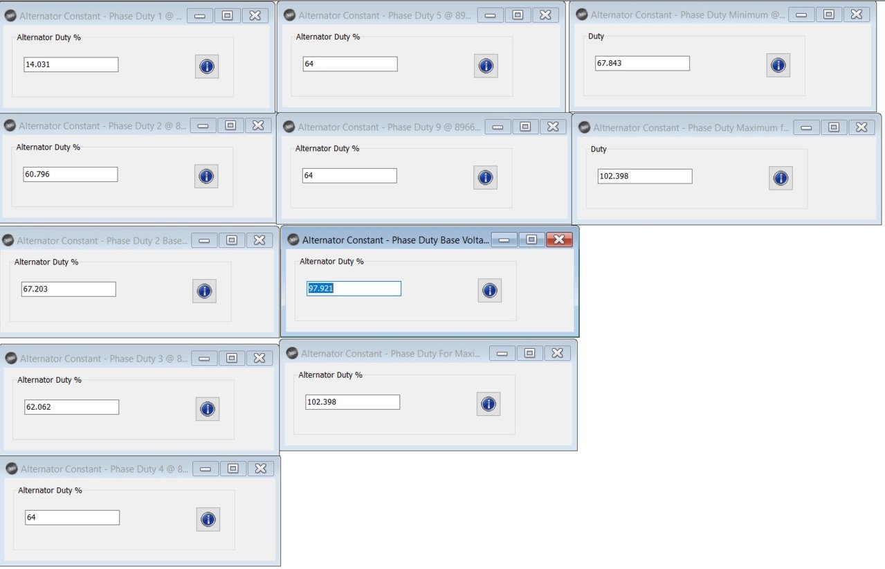

    On another note, has anybody figured out how to switch the fuel learning curve to run on premium fuel? I'm running Mooseditty17's stacked throttle tune(love it!) with the AGM settings I transfered and saw that he based it off the regular fuel file and not the premium one. Is it as simple as changing a certain map definition or would I need to match everything he changed in the reg file to the premium file?
  5. Sep 24, 2020 at 5:31 PM
    #5225
    lapoltba
    lapoltba Full Bridge Rectifier
    Aug 28, 2014
    #137089
    3,346
    CT - 06076
    '17 Sport, ACLB, V6,MT, 04B14 OV-Tuned
    Copy the throttle tables and AGM settings to the Premium tune?

    I’ve done most of this for 04B04 premium stock 33. I didn’t do his shift modifications, but have everything else done. I’ve made a few other minor tweaks. I also applied the throttle changes to S-mode which the original didn’t have and modified for AGM to get 14.3 14.5V. I was going to flash it tonight and run it through the weekend.
    I skipped his shift Point mods as those seemed more geared towards towing which I don’t do much of.

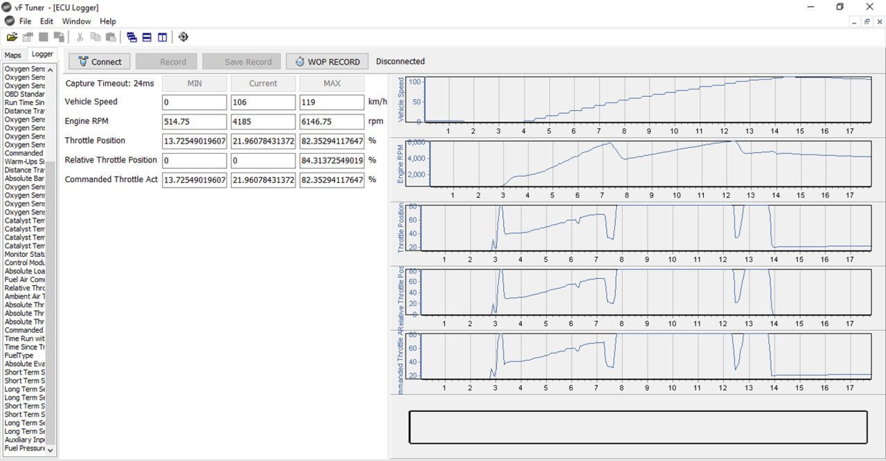

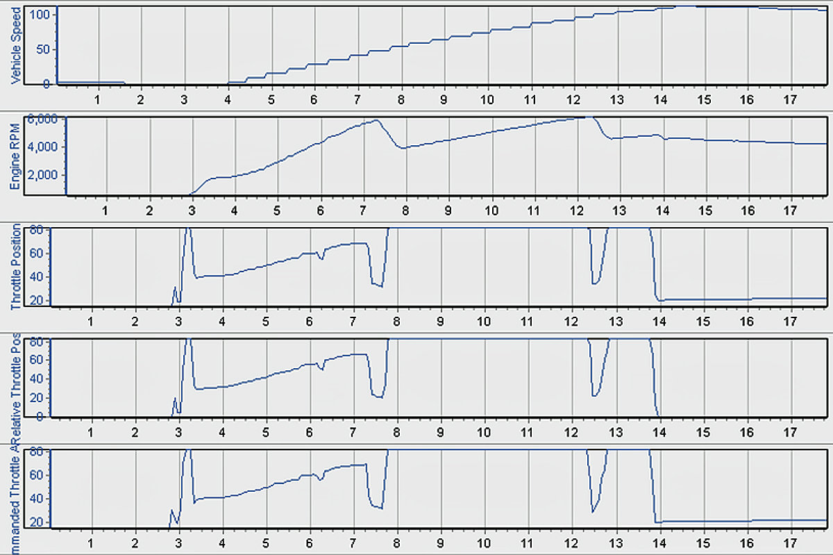

  14. Sep 24, 2020 at 7:59 PM
    #5234
    WHTLTNG
    WHTLTNG White Lightning
    Apr 13, 2020
    #324611
    40
    I made the changes in my post above and nothing changed.
    Here is a log. Assuming >80% is full throttle, I can get full throttle in 2nd and 3rd+. I can't get full throttle in first gear. Is it possible, If so what do I need to change?
    For this log, I stomped the pedal abruptly from a dead stop and abruptly let off shortly after shifting into 3rd gear (like an on off switch).
    Zoomed
