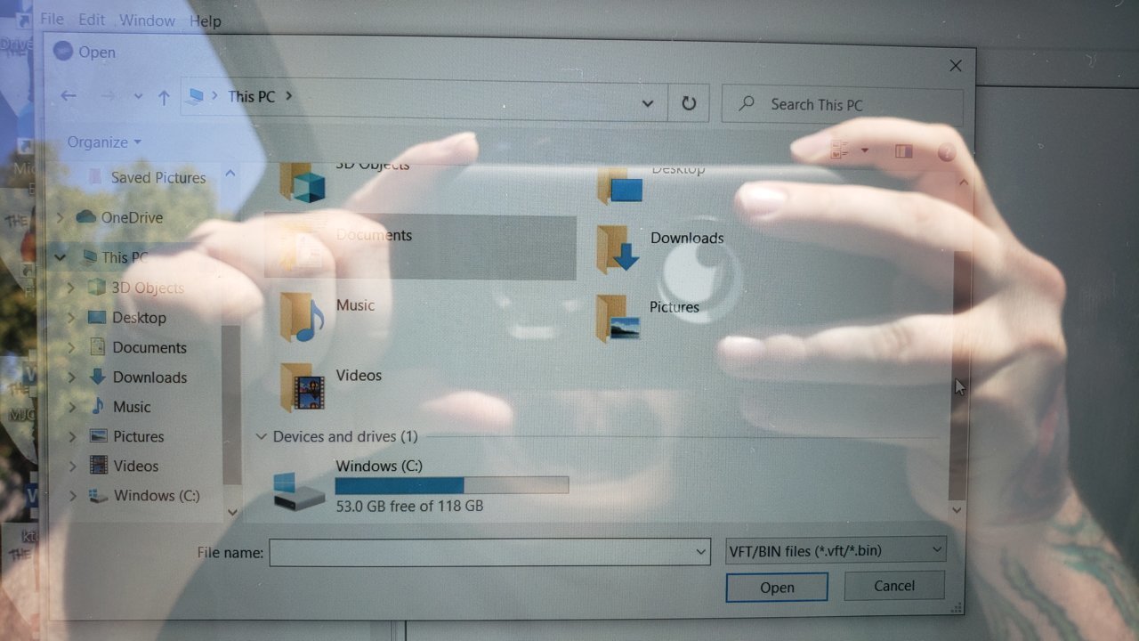

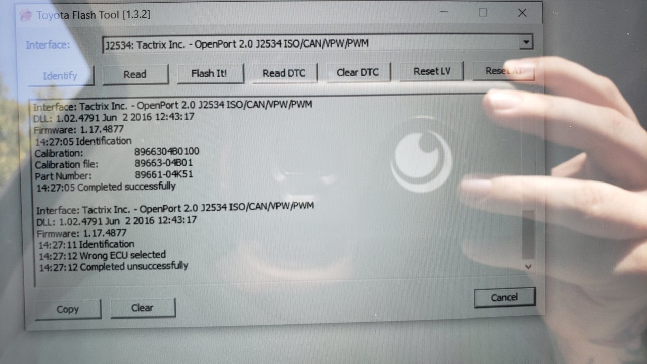

    trying to use credits to unlock my ecu the drive in the user manual is not showing (d drive ) I can flash the ecu but I'm not showing that my ecu has been unlocked or that I have used my credits please help

    Yes the drive is not appearing

    What ecu ID are you?

    Doooooooooood! Don't unlock that ECU.
    Update to 04B04 first:
    https://www.tacomaworld.com/threads/ecu-tsb-update.562550/
    You're in for a treat.

    Through techstream. There's a link for texhstream and the file to update in @tonered signature

    Yes. You will use the orange Tactrix. Just follow along in that 1st Post, install TechStream, and load up that T-0034-18.cuw file.
    You will need to have the Tactrix drivers installed.

    Ok and if my original problem still occurs

    As far as I know I have them installed and up to date I had to do that just to get the vf tuner sw to work

    I'm not even sure there is anything released yet for 04B01 yet, but could be wrong. Once you update to 04B04 you will be good to go. Not to mention just that update alone you will notice a huge difference!

    Get techstream installed then. After you confirm it works, close it down, then double click on the T-0034-18.cuw file.
