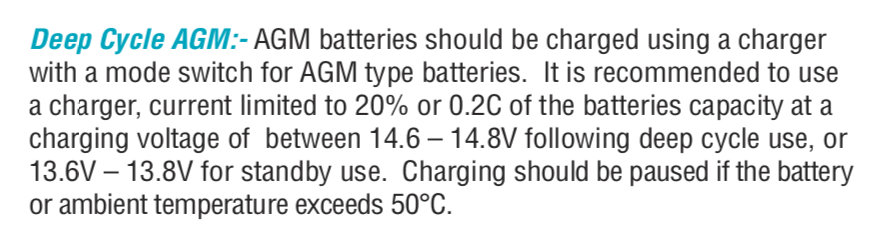

    I think 14.6 is pretty close to max.
    fatboyfirebass likes this.

    AGM Not exceed 14.8 max

    Between 14.4 and 14.8, so 14.7 would probably be good.

    Confirmed here as well - thanks! Measured 14.33 at the battery both during initial start/high idle and when warmed up. Northstar indicated anything 14.1 and above is sufficient for their battery, so this is perfect without asking too much of the alternator. Now I'm curious what else was needed.
    https://northstarbattery.com/faq
    GPatriot and ihatemytruck like this.
