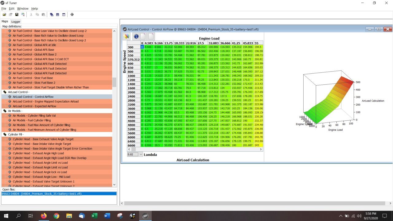

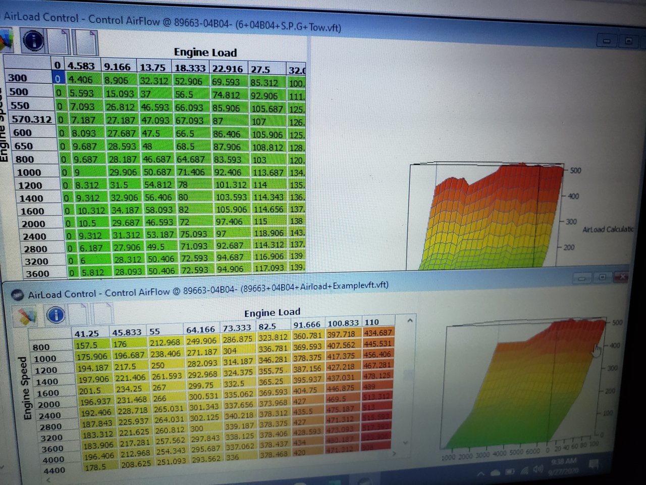

    Just curious did you eliminate all the humps or just the one in the 800-2000 range of all 4 tables?
    I also smoothed out each engine speed column like above after doing the 800-2000 range. But, I only did it only on the .99 tables because I didn't understand until your post what Mat meant by 4 axis and 4 tables. On a couple drives it seemed fine without any dead pedal.

    Just humps and dips for .82&.99 im 800-2000 and it drove very good, but I started noticing some limitations.
    Also noticed that when I "smoothed" out the range I had a big gap between numbers in some areas. Mat's example had better transition. Perhaps that transition was felt in stop and go traffic.

    Anyone else notice that Mat's values were identical for the 0.82 and 0.99 for both Control Airflow and Expected Airflow?

    and as another note, the air control files are exactly the same between 04B04 and 04A61 so the files Mat posted applies to 04A61 ECUs too
