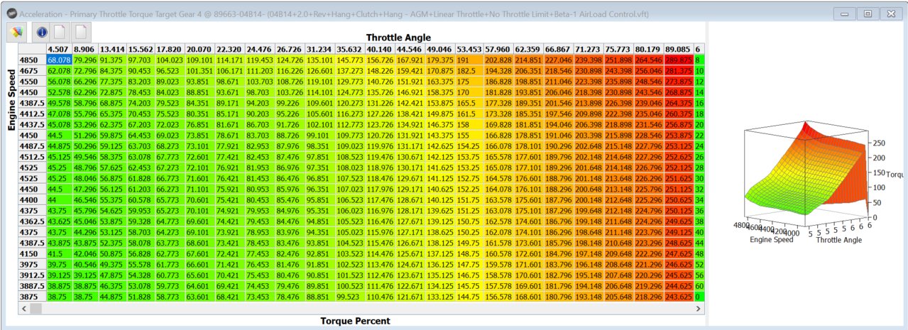

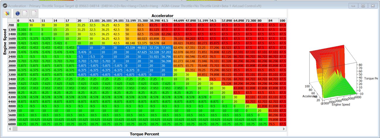

    Are you referring to the "Acceleration Shifting" tables at the bottom of the list in vF Tuner? Specifically the first "Acceleration - Primary Throttle Torque Target" one? The first table is the only one that displays the RPM range that I was interested in, so I'm guessing that why you called that one out? Would you have a recommendation on how to approach this? Maybe smooth (ctrl-I) the range I'm interested in?

    Nah. That first map (Acceleration - Primary Throttle Torque Target) is your throttle pedal. You can edit it, but I found that is only narrows the response range. Sort of like a Pedal Commander since 87.5% is the max angle. I intend to play with it more in the future, but the Air Load Control or the Acceleration - Primary Throttle Torque Target Gear 1 will do what you want. @OVTune said that Gear 1 now applies to all MT gears.
    I edited the Air Load Control maps (and am extremely happy with them) before @OVTune noted that they were mainly for the AT.

    bottom map,
    however looks like it is showing wrong. I will post a new version 1.2.5.6 that corrects this.
