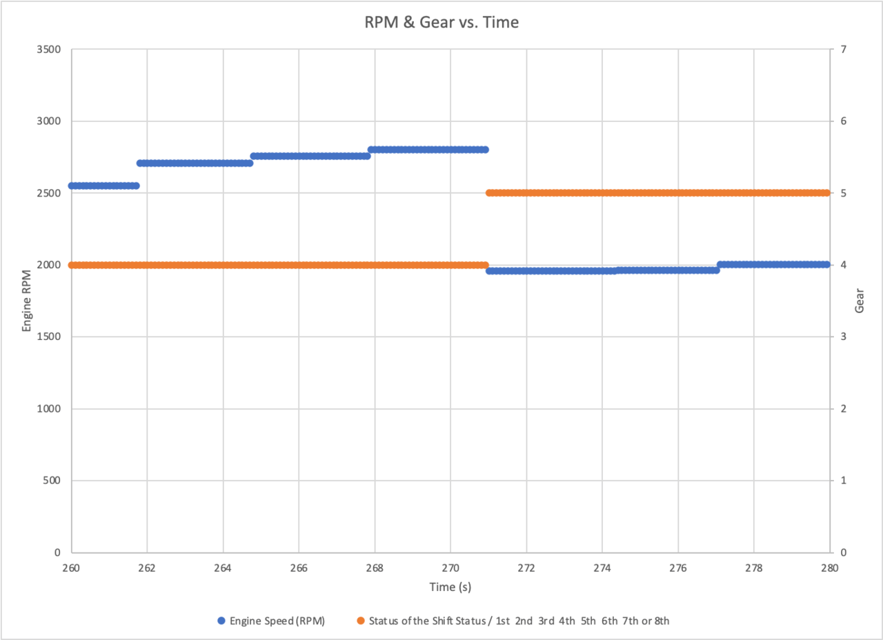

    I plotted my log from the drive home. OBDFusion set at 200msec logging. It's clear that it's logging data at that rate, but data only updates at 3 second intervals. Here's a plot below that demonstrates that. Perhaps as mentioned, it's a limitation of OBDII and it'll never get better. I made some tweaks to my OBDFusion settings and we'll see if anything changes on my drive in tomorrow. There's also a built in log view that I haven't looked at.

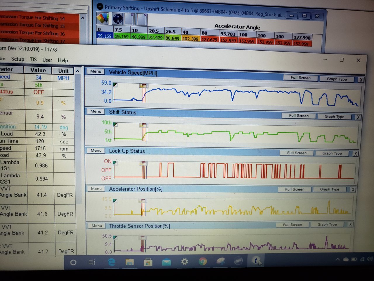

    I'm going through the log and it seems speeds in those table are in kph. My math suggests the same(+-), but I could be wrong.
    Here is 4 to 5 upshift at 34.2 mph.
