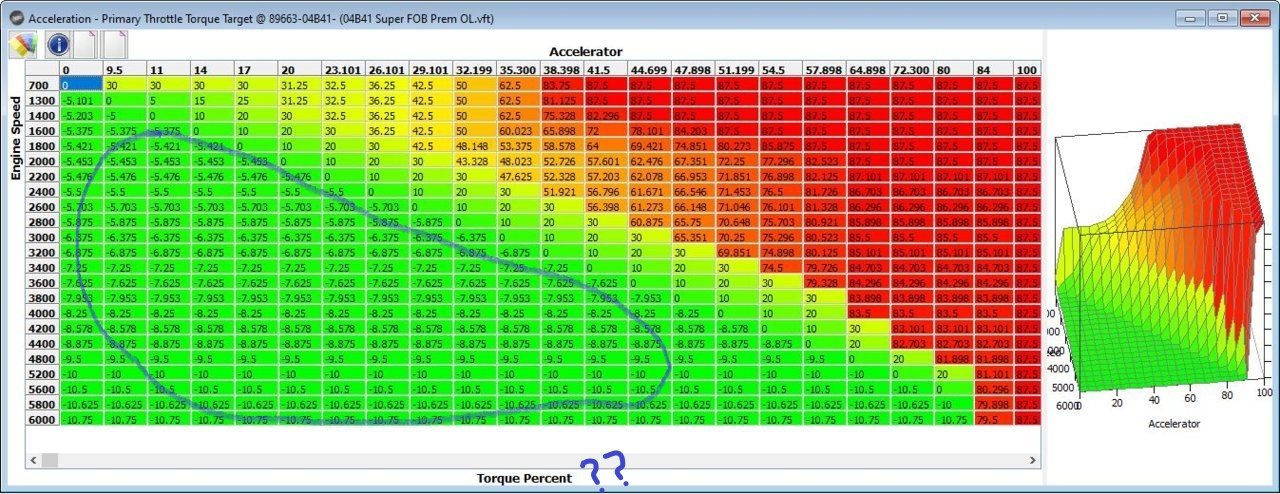

    @OVTune
    Please advise what these negative values mean in relation to % Torque as indicated on the following map (04B41 Prem SFOB, Primary Throttle Torque target):

    464
    2018QSDCLBSR5
    Enhanced Skinny Pedal
    I don’t know exactly. I imagine the truck makes some calculation to determine if it thinks you are accelerating or cruising at constant speed. Then it would pick the map based on the results of that calculation. Just seems like a ham fisted attempt to patch the inadequacy of the primary maps in my opinion. I upped my accel maps so there are no shift points slower than my primaries
    Mooseditty17[QUOTED] likes this.
