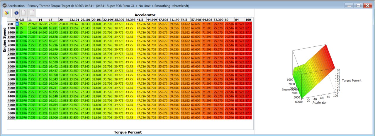

    tonered
    tonered bartheloni
    Sep 25, 2017
    #231055
    31,202
    tony
    Lynnwood, WA
    Yes. I had that problem. It was over smoothing the Air Load Control maps. See my thread in the Perf and Tuning forum. I posted up the bad version and the new version that is rocking it.
    I can send you a spreadsheet with the maps to copy and paste if you Stock values match 04B14 Stock / OVT also posted.
    Yes on the throttle. I have been struggling with this since new. And, the fact that even in DFCO, there is still significant fuel flow. Much more than idle.

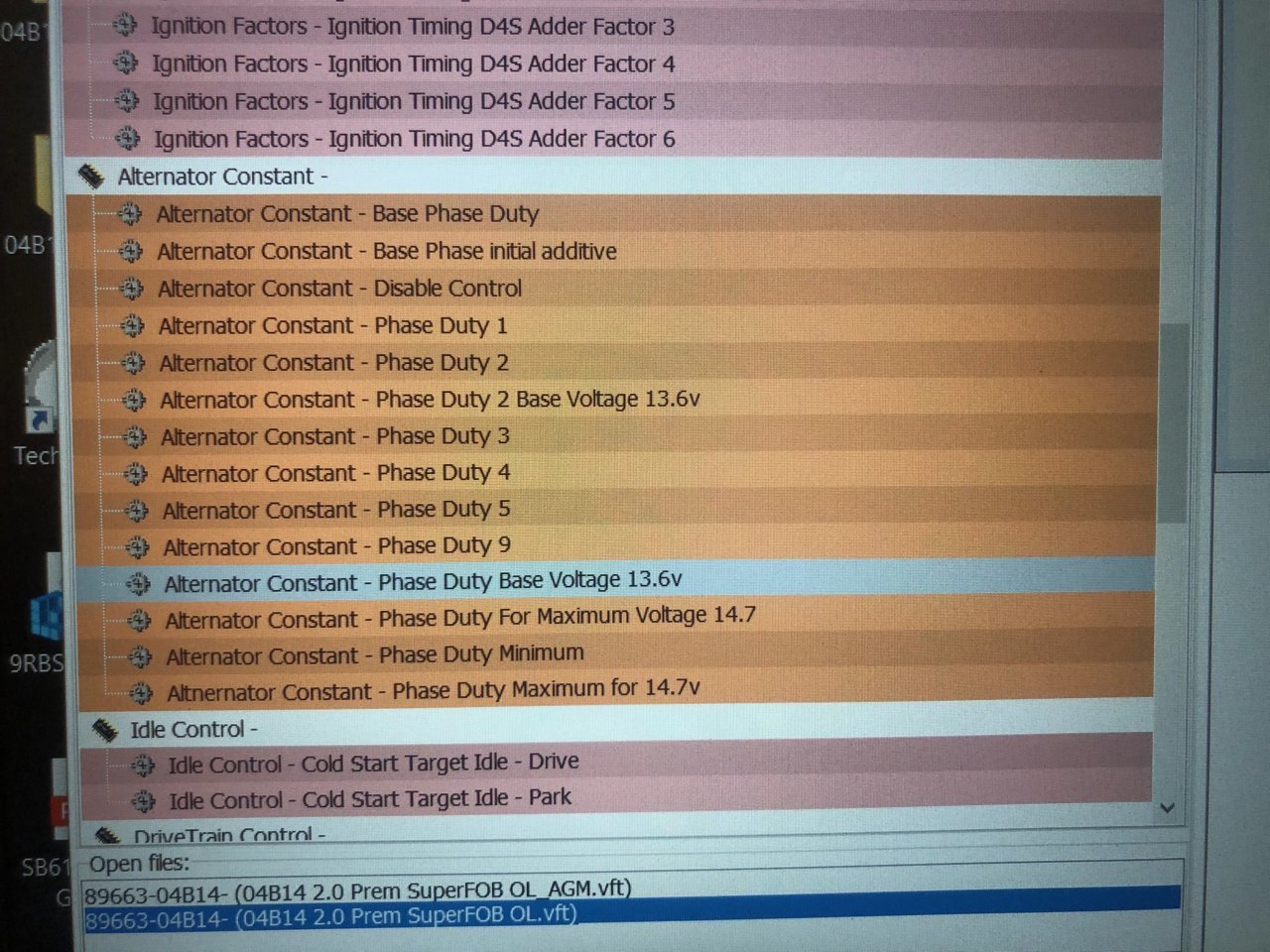

    banjoist13
    banjoist13 Well-Known Member
    Sep 5, 2016
    #196465
    74
    Ian
    Humboldt County, CA
    2016 Off-Road 4x4 Manual Transmission
    BAMF Alumisteel front bumper, BAMF dual swing high clearance rear bumper, RCI full skids, C4 Fab Rock Sliders, Rago Fab LCA skids & rear shock mount skids, Method Trail 701 Wheels, ARB dual onboard air system under hood, Taco Tunes speaker system, Rago fabs center consol MOLLE, Weboost Drive Sleek OTR, SDHQ Billet Battery Terminals, Gofast Camper, Morimoto XD headlights and taillights, Accutune custom tuned Fox 2.5 adjustable front w/650lb Eibach springs and rear shocks, Deavers stage 3 leaf springs, Martin off-road camper rack, Cammo & Covers Tactical Seat covers,
    I am looking at the Alternator constants for the SFOB 04B14 2.0 No dump file and I am not seeing all the Phase duties that everyone else seems to have in their posts. Anyone know what might be why this is?

    Phase duty 6/7 were renamed

    Thanks! what are they now?

  18. Sep 29, 2020 at 6:43 PM
    #5598
    banjoist13
    Sep 5, 2016
    #196465
    74
    Ian
    Humboldt County, CA
    Big thanks! This thread is a beast of a mess to sift through. I have spent the last few days going through it to try and figure things out.
