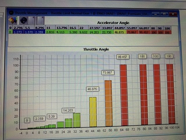

    I don't think I went over 100 either. But Im fairly certain the truck wouldn't allow it to try and go beyond what is capable. Another tip. Keep first second and third values close to the same if not the same across their ranges. Makes for smoother acceleration.

    1st, 2nd and 3rd values such as these (highlighted) for all 6 maps?

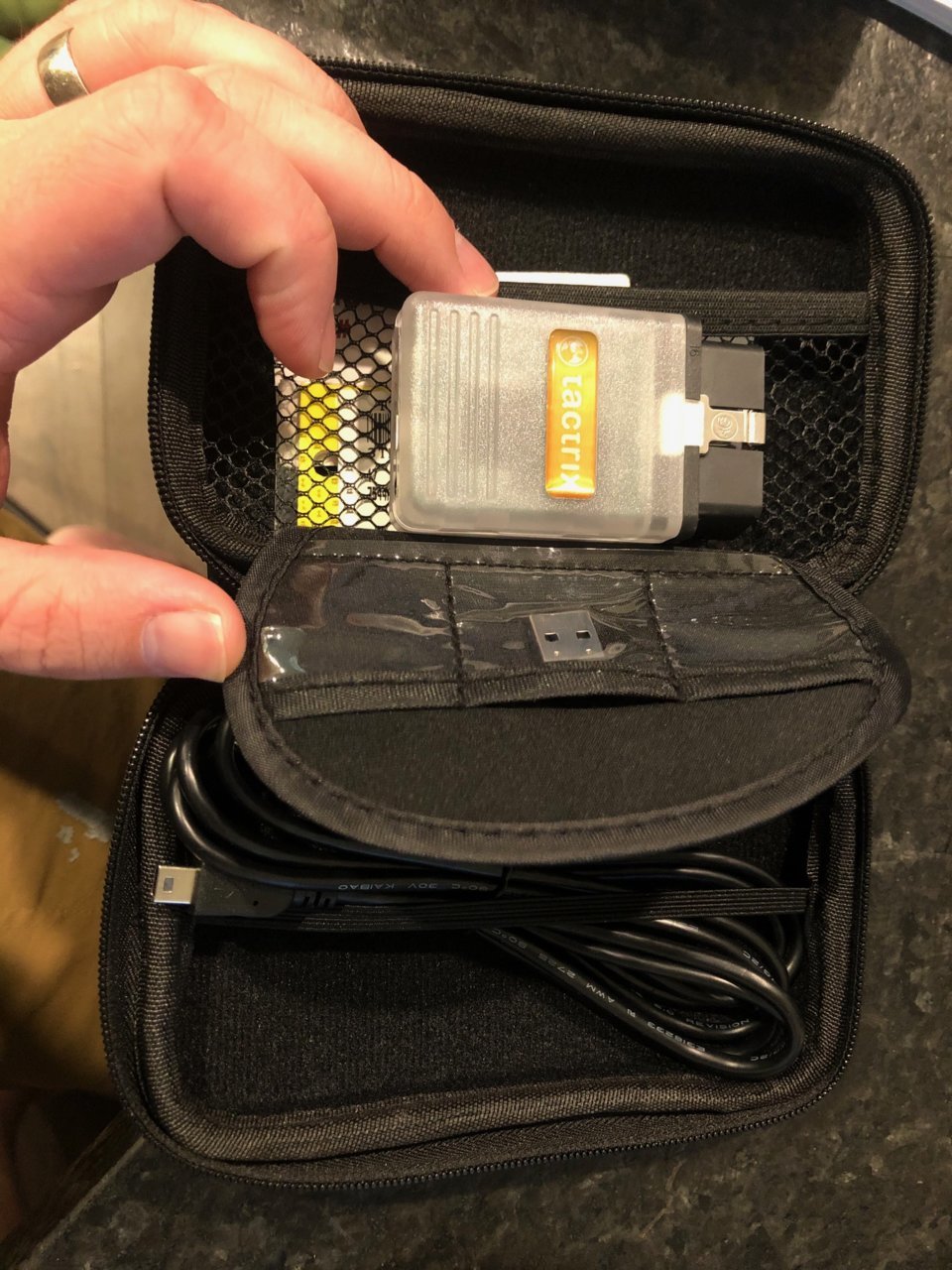

    What exactly is the dongle? I have a
    Thank you.
    Is this the dongle?

    disregard the tactrix plug and cable and pull that little USB out of the plastic. If it's black or purple then that's your dongle. That'll get sent back and KEEP the tactrix and cable as you still need it to flash your truck. Directions to upgrade from dongle to VF is on OVtunings website

    The entirety of that map, should be close to or have equal values as the entirety of the 2nd and 3rd gear maps.

    All 3 maps should look the same or at least be close. Otherwise, 1st gear is... Waa... Second is, waaaaa, and so on. You want waa for both... Keep them similarly increased in values.

    So what I'm understanding is the 1st gear, 2nd gear and 3rd gear maps should be exactly the same from 0 all the way to 100? Sorry if I'm misunderstanding, I'm not too savy with tuning yet.

    The USB piece is black, so that's the dongle. I'll go ahead and place the exchange order.

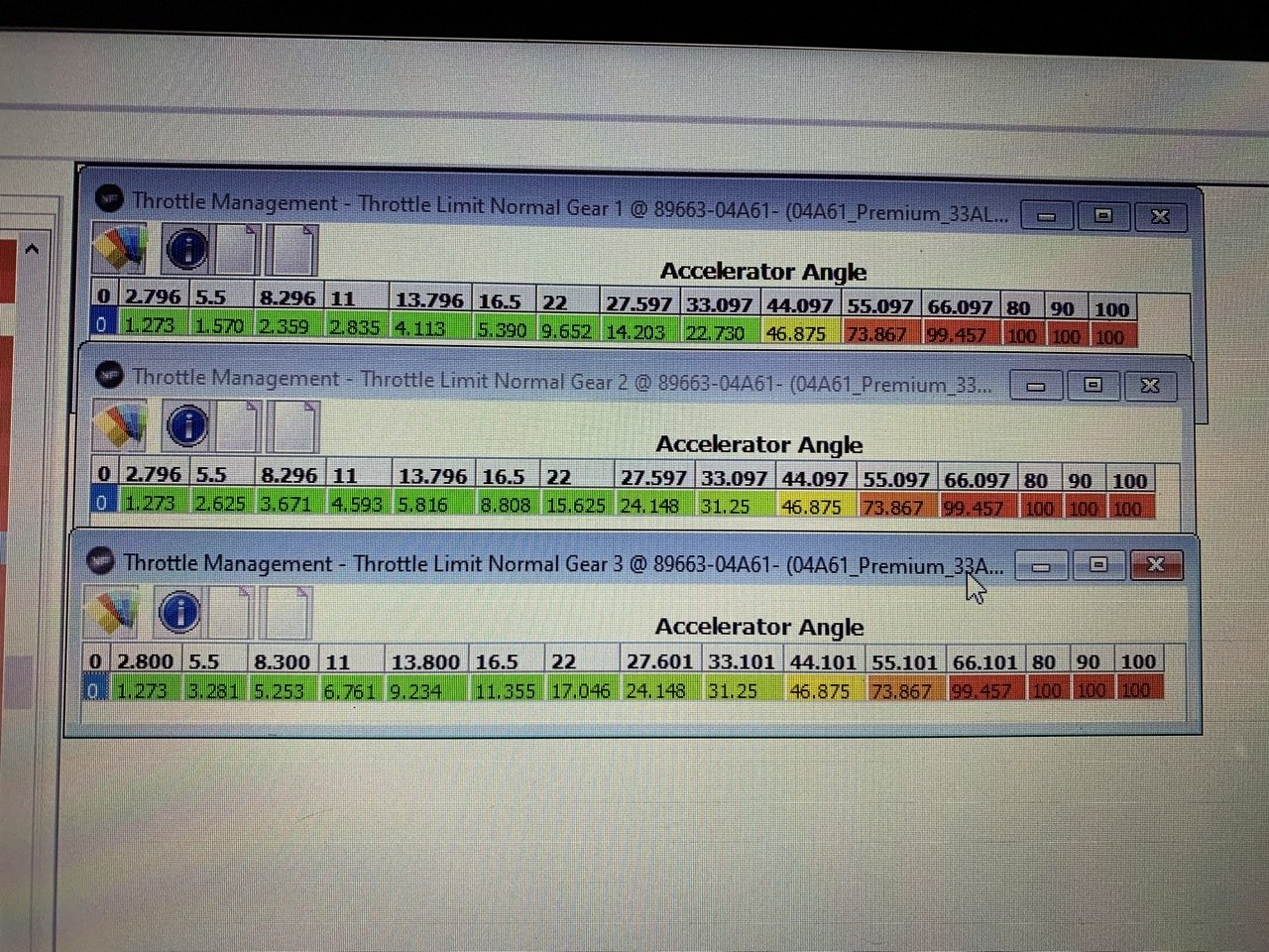

    Here’s what my 1st 2nd and 3rd maps look like. Similar for the most part but a few different values.
