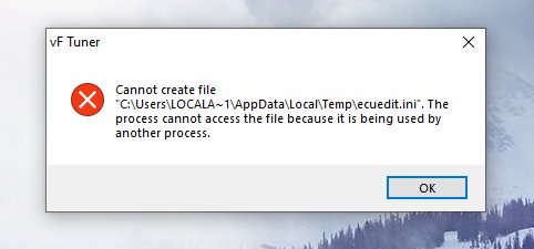

    Can anyone explain why I am getting this, but on the 3rd try VFTuner opens? The error persists, but I close it. @OVTune ?

    The first step of troubleshooting is always "Did you turn it off and back on?"
    Try restarting your computer.

    Ive seen it pop up a couple times. I think usually its cuz vF is trying to launch but hasn’t opened yet.
    I just launch vF and come back in like 5
    I also check task manager to make sure its in there and actually launching.

    I've seen that before... sorry though, don't remember what I did to get rid of it. Maybe you tried to open vF Tuner more than once? It only takes 5 Minutes to open o_O You might check Task Manager to see if if shows multiple "vF Tuner" Apps.

    If you’re on Win10, apparently VF takes a really long time to finally come to fore. If you relaunch before the first instantiation completes, something like this will happen.

    Thanks, I work in IT, so that was what I started with.

    Interestingly, the few times I’ve launched VF on my bootcamp 10+ yo MacBook Pro, I don’t recall it taking very much time.

    Makes total sense along with what @Shellshock mentioned. Thanks guys

    I also found this and reported this via ZenDesk yesterday. I was able to reproduce it by attempting to save a file I had exported in that session with vF. Steps:
    Open vF and a vft file
    Export with new name
    Make changes
    Save -> Error. Also, error if trying to export to the same new name.
    Close and reopen vF -> the file is unlocked.

    ??? Front and Rear Diff and Tire Size (remember to enter radius not diameter). And as noted it takes a LOOOOOOOOOOOOOOOOOOOOg time to load. Also use Export and not save - that way you can name and place in a different folder to keep from over-writing files.
