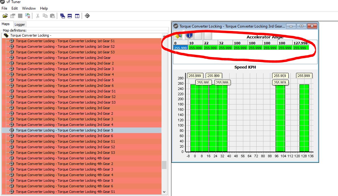

    SUPER STOKED to announce this guys! This was my last quality of life mod I wanted to figure out, aside from the big power of course..
    I figured out that one of the TC unlock/lock maps we are able to tweak does in fact change the partial TC locking and unlocking!!! Whats that mean? For any of the AT folks out there that have the dreaded double-upshift-then-downshift-again feel when the trucks shifts from 2-3 around 18-23 MPH this is for you! This was probably the most annoying gear hunt feel I had whenever I was slowly/moderately accelerating around town. What it was doing was partially locking and then full unlocking again. The log would show a full unlock the entire time because it technically did not lock. I haven't dialed what map it is but if you modify the following maps by setting all the cells to the HIGHEST number in each table you will get rid of this madness.

    If you have 04B04 (sorry cant confirm other ECUs) make all of the tables I listed above look just like this and your issue should be gone. I drove around the area for 40 minutes forcing it to try and replicate the issue and not once did it even hiccup and do the double upshifting. Give it a shot!

    I found the table that actually affects it. I was hoping there were separate maps for ECT and D but unfortunately not. Anyway the map that you should be able to tune and leave the others alone is Torque Converter Locking 3rd Gear S2.
