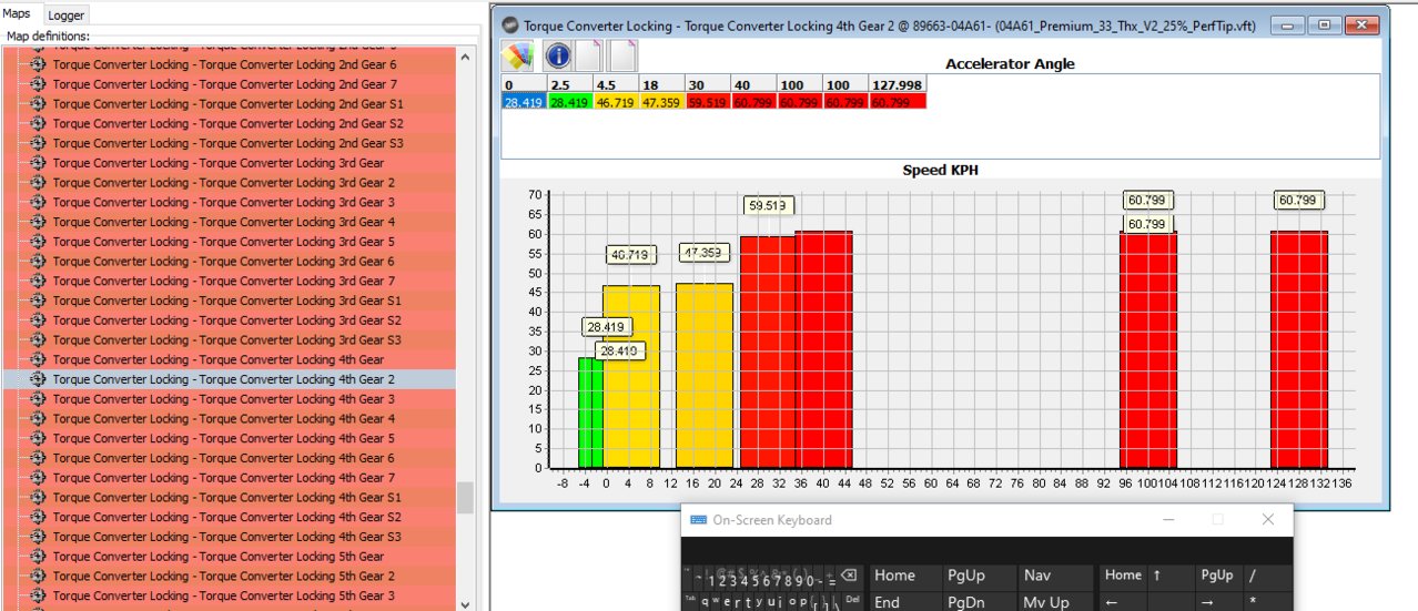

    Is this the table you're referencing which would raise the locking MPH instead taking the lock out completely? 4th2.jpg
  19. Oct 3, 2020 at 4:46 PM
    #5839
    ForceOfG
    ForceOfG Well-Known Member
    Apr 20, 2018
    #251122
    154
    Portland, OR
    16' DCLB 4x4 Off-Road
    5.29 Yukons Stage 2 Icons 265/70/17 OVTuned
    Yup thats the table for 4th gear full locking (and table 3 is used when you're in ECT). Now that I think about it, if your lugging around 40-45 thats probably 5th gear TC. Same map numbers would apply though. Locking 5th gear 2 and S2.
    wahoobie likes this.
  20. Oct 3, 2020 at 4:49 PM
    #5840
    ry18Tac
    ry18Tac Well-Known Member
    May 1, 2019
    #292021
    348
    North Texas
    2018 Quicksand Tacoma TRD 4x4
    Ovtuned
    Yeah it could be 5th. I'll just raise 4th and 5th gears 2 tables by 10% and see how that helps.
