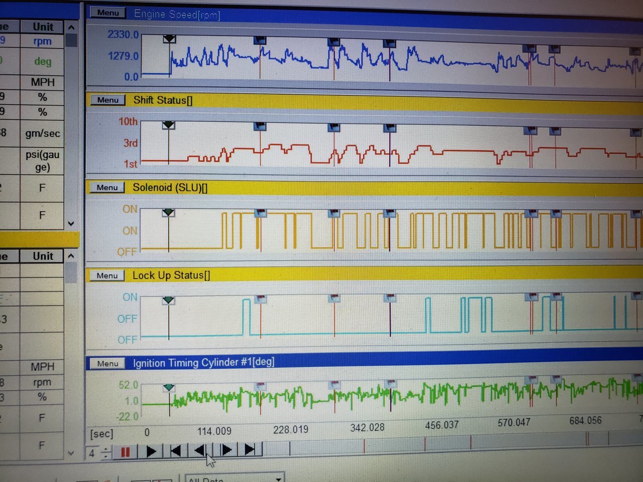

    I have been chasing this issue for a while and was looking at it from different angles -VVT, ignition, tranny shifting, TC locking
    A few times a logged tranny solenoids and there is SLU solenoid that turns ON a few seconds prior the even, while TC remains unlocked. I just put mod for 4th and heading out to my pickup game and see the outcome.
    I'm not sure how it will affect the entire spectrum of 4th gear.

    @Mooseditty17 @Vlady Thats correct. I could replicate it all day with the 3rd gear fix I mentioned. I believe techstream only shows whatever state it was last in whenever it goes to half lock/unlock. So if it was locked and then half unlocks it will still show a full lock.
    I would increase the first 4 cells in the 'Unlocking 4th Gear 2' Table by 5 or 10 and see if that helps you. By increasing these numbers the result is going to be less pedal as speed increases will cause a TC unlock.

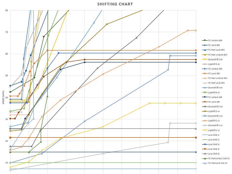

    What I've done is started graphing all of the shifting and TC tables to make sure I dont have any overlap. Makes it easier to visualize when something is happening. I'll try to share this file if anyone wants it for their own use.

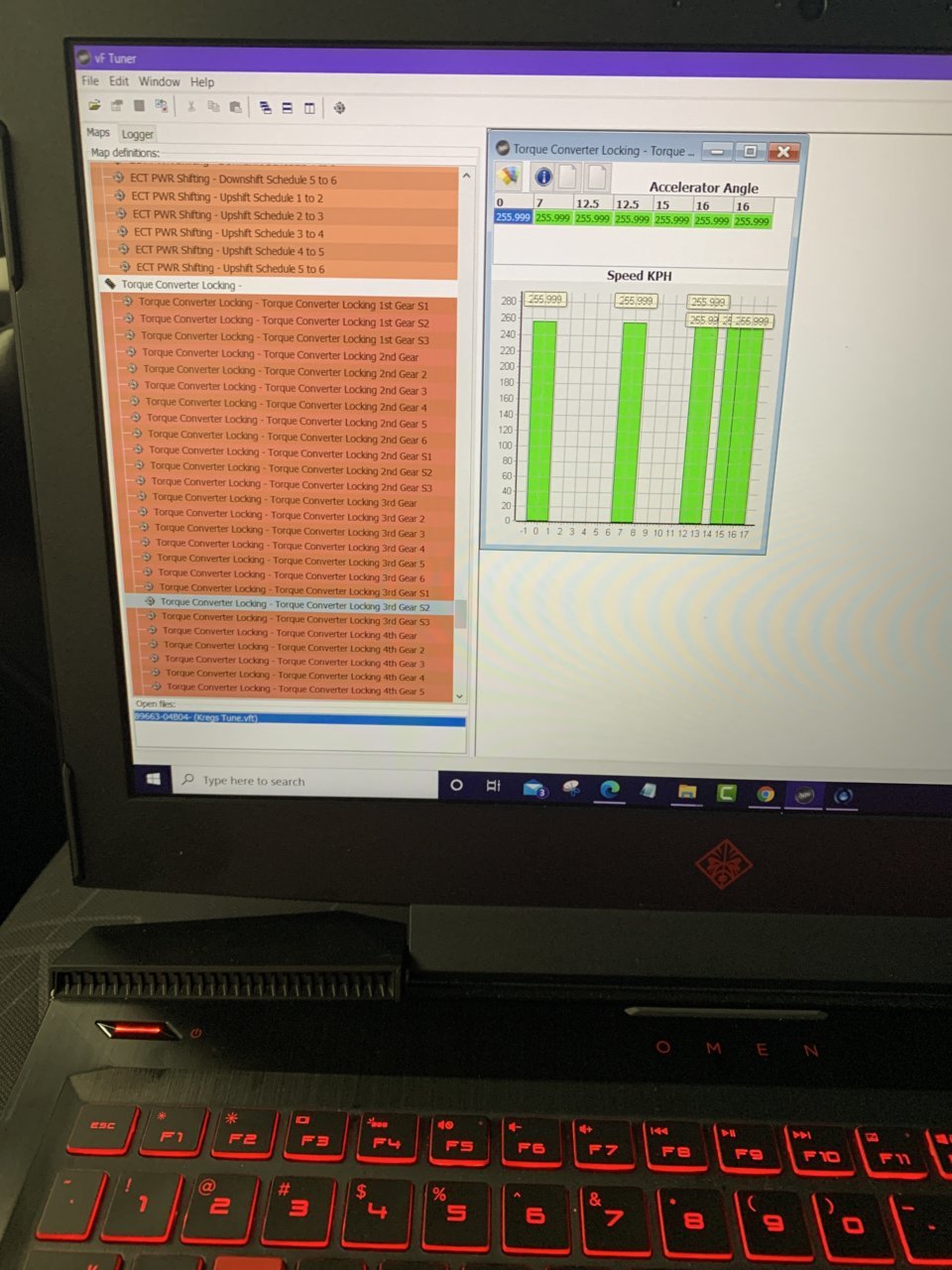

    So, reading through this numerous times... And, now going cross eyed. I have a question. (I'd just go try it. But, my garage is a ways away.)
    The change is to be made in...
    "Torque Converter Locking"
    "Locking 3rd gear S2"
    And...
    "Unlocking 3rd gear S2"?
    It needs to essentially be locked out from doing both, correct?

    You only need to mess with 'Locking 3rd gear S2'.
    I'm not even sure if 'Unlocking 3rd Gear S2' is even used in the stock maps because the truck would need to lock in 3rd in order to use that map. That map is for switching from full lock state to half unlock but the trucks stock map prevents it from ever even locking in 3rd.... :crazy:
