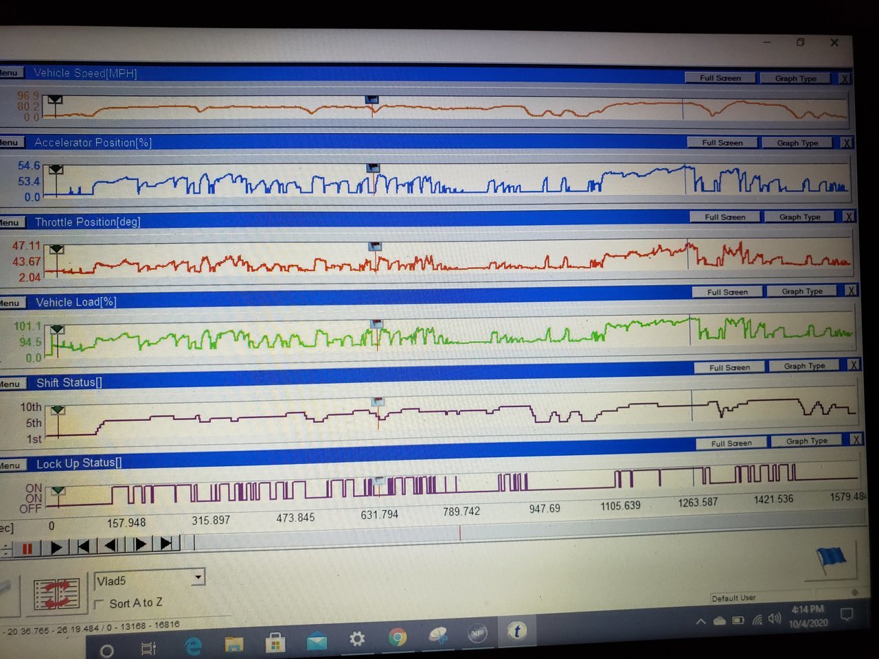

    Here is my progress on fixing dead pedal issue in 5th gear (1105 -1263 sec )
    Doing 80 mph in 5th, tc locked on on long incline. The tranny did not kick down to 4th at all.
    The mods I run is only airload tables + tc lock/unlock for 3rd and 4th. I got rid off other mods.
  11. Oct 4, 2020 at 4:31 PM

    I did left those curves , but I interpolated number on both sides of the curve

    Is there any rhyme or reason to your airload table changes? Or are you just nudging a bit here, stretching a bit there, and seeing what happens?
