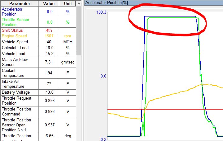

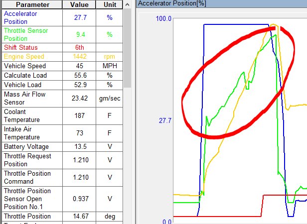

    Nothing really.. I modified that map again and made it completely linear and modified the throttle limit by gear tables the truck feels as direct as it ever has now. I did end up testing Matts example file with the added gear lock and maxing out the first gear throttle limits and I came up with the same results as you. I can get full throttle at any RPM in any gear but its still limited in 1st gear.
    1st gear on the example file:
    Every other gear:

    Do you have a picture of the map now? I haven't made mine completely linear yet but the change I made has seems to make the throttle more responsive as you keep digging into the throttle. I need to compare my logs but haven't had time yet.

    Does anyone with an automatic transmission have any logs showing full throttle in first gear? My truck doesn't get full throttle in first gear as well.
    @OVTune Do you know any older tunes for 04A61 that should get full throttle in first gear that I can try and log?

    Hasn’t 1st gear full throttle been covered? You need to also modify the air load tables. And 100% is really like 85% so the flapper doesn’t get stuck open. And fully closed is like 15.

    Yes it has been discussed but no remedy. I have modified the air load tables, etc. First gear never changes.
