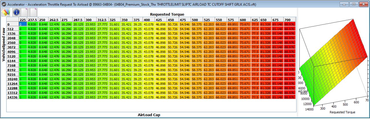

    I did some simple math to get how much I'd need to increase each cell in order to make it linear. Here is the full table. Realized I didnt have that on the last post.

    I’m pumped to give this a try along with your per gear tables. Thanks for posting it!
    That looks like one hell of a tune by the name lol
    Did you make your airload tables smooth like that also?

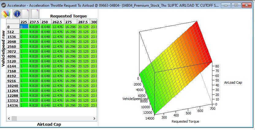

    Did you do anything to the 2nd map too(accelerator-request to airload) or did you leave that one as is?

    ended up being unable to add this, as the ECU didn't like it, it didn't work as expected.

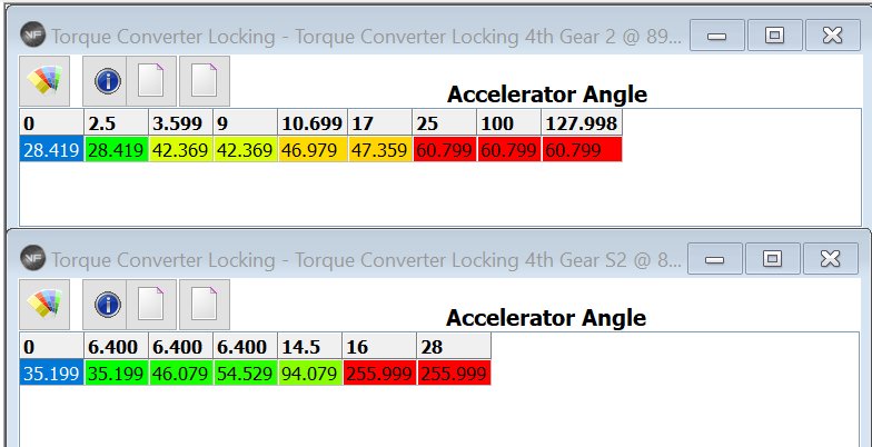

    @Mooseditty17 or @ForceOfG can you post screenshots of the original 4th gear TC locking values in your file? The 04B80 2 and S2 logic seems to be reversed, with partial locking being requested 7 higher than a full lock. Maybe I am not fully understanding the partial/full lock concept?

    Mooseditty17
