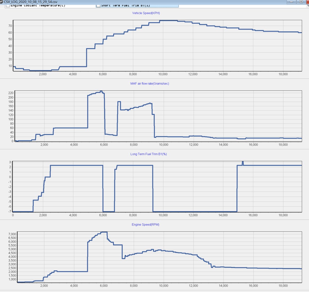

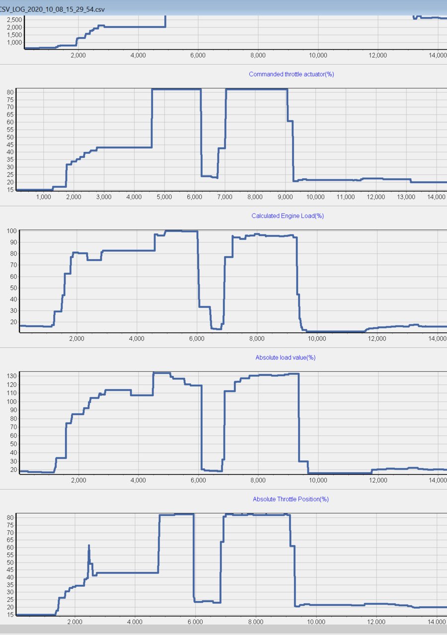

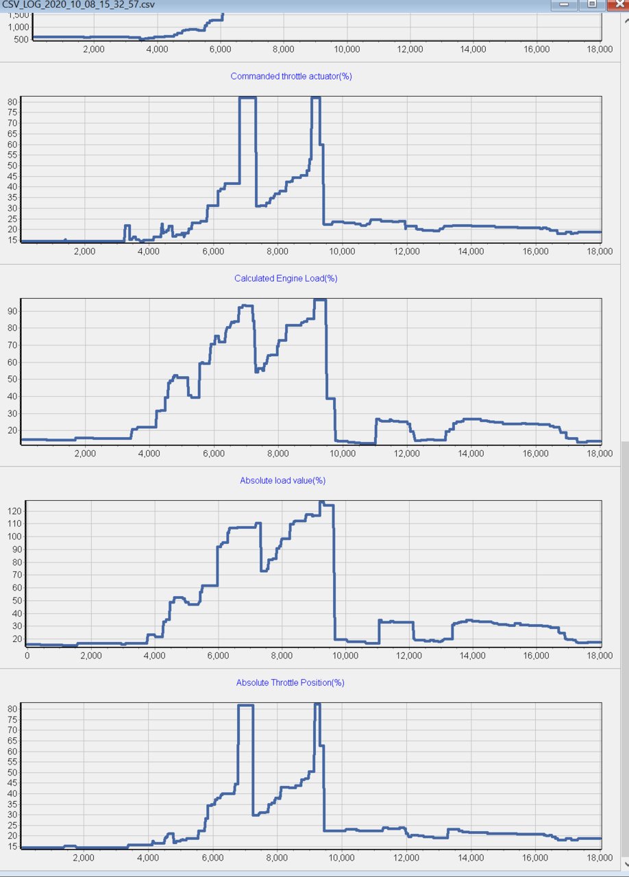

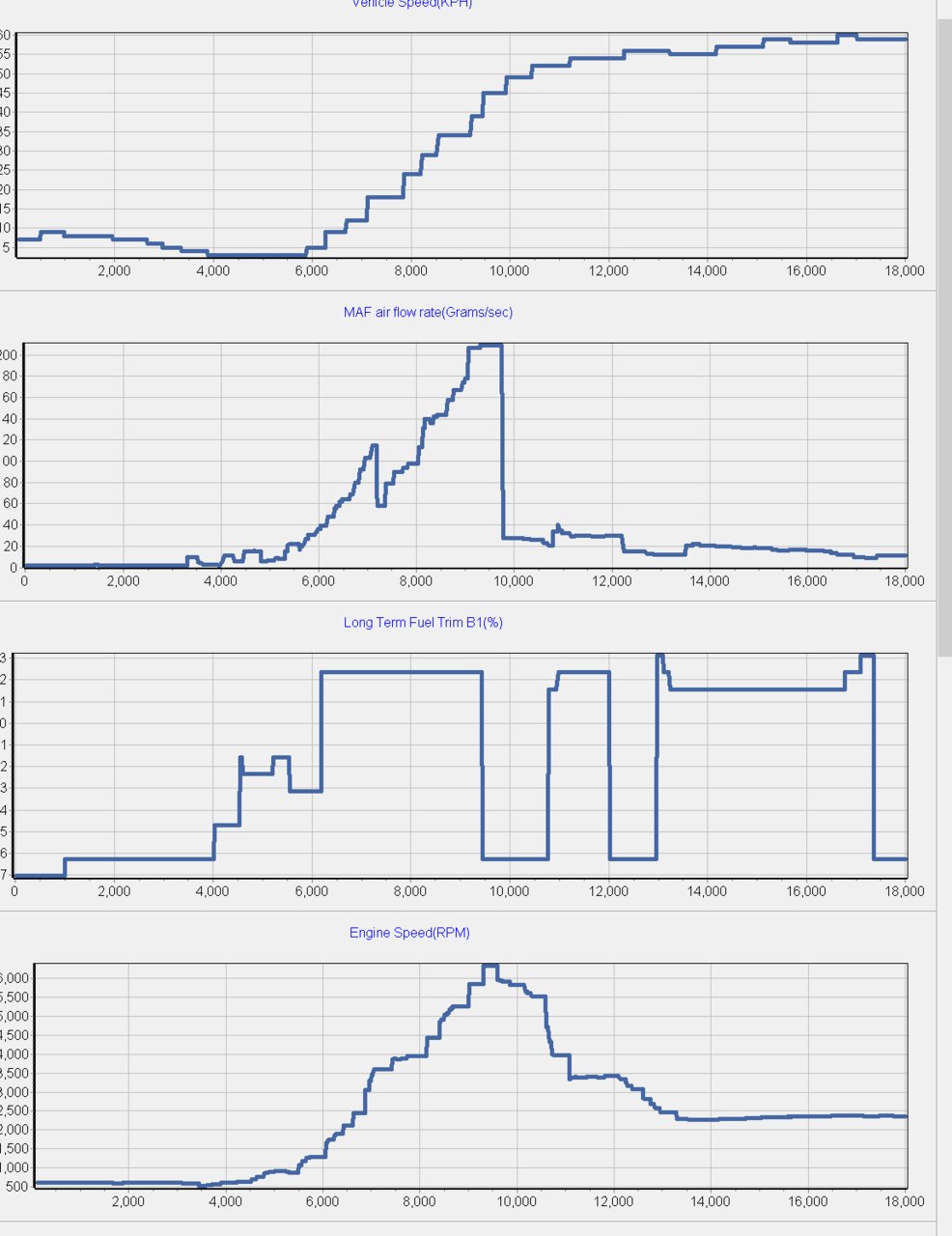

    This is what I grabbed with a couple quick pulls.
    Pull 1:
    Pull 2:
    I think that looks great?

    Whachu seeing?

    We're those first gear?
    I'm still seeing it being limited by rpm.
    Notice i never went to 7k but your throttle doesn't appear to open to full until your rpms ride up

    Both were 1st and 2nd gear.
    It looks like full torque at about 2k? That seems right if the log is jiving?
