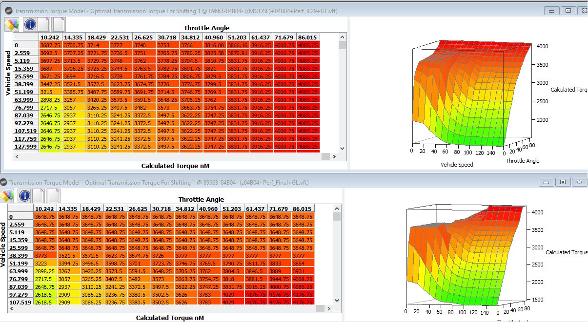

    I would think a minimum of fixing the huge flat spot on the upper left hand side is the major factor. But I can't imagine why the first gear values differ SO MUCH from the rest...
    :annoyed:
    I sure hope Saturday gets recorded and posted because I'll be on a youth deer hunt with my boy, but I feel like I'd understand things like this crazy ass first gear map much better after a webinar.

    but is it just for gear 1 is the question. It say optimal torque for shifting 1 but there are 17 of them so I question that it's for a single gear or are there 17 different models the ECU can pick from to use and each map controls all gears?

    Mat suggested upping this map in particular. Not how, that's up to us vigilantes!

    map 1 has lower throttle angle percentages and lower speed inputs so I'd assume it was for gear 1 and is a more refined map for low speed driving like gear 1 but then why are there 17 maps instead of just 6 and 1 reverse? Map 13 also has lower speed and angle inputs. I wonder if copy paste from there would be smarter? Map 13 actually looks good if I had a clue of what I was looking for in a map

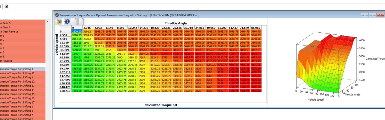

    This more along the lines of what you were thinking? Trans Torque comparison.jpg

    That was closer to my initial thoughts but after looking at map 13 I'm wondering if that's going the wrong way and dropping the low angle, low speed torque requirement is better? I'm way out of my paygrade on this stuff though. I grew up on changing jets on carburetors and points ignitions with a manual trans so this is all foreign language now for me

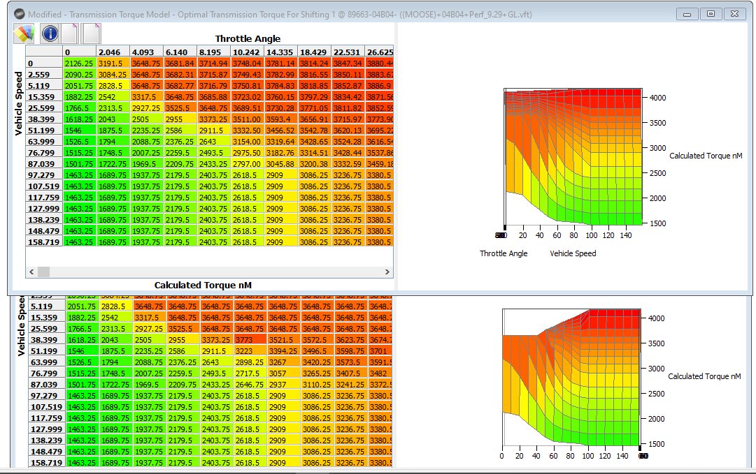

    Will raising these values make it shift harder / more aggressively?

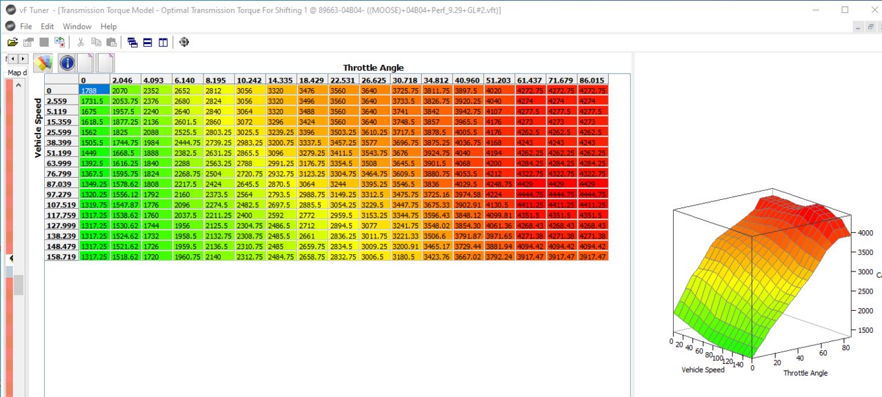

    Any thought to smoothing it out like the throttle? Same across the board with a nice incline?

    Been there done that. It made zero difference. I've made some aggressive changes to that table.

    To some extent, it must be jacked up for a reason... I would still think moderate smoothing is in line though. Mostly increasing values in the huge flat void is my guesstimate as of now. I'm not certain if this will modify how hard the vehicle will shift now though. I'm apprehensive, until I know more about it.
